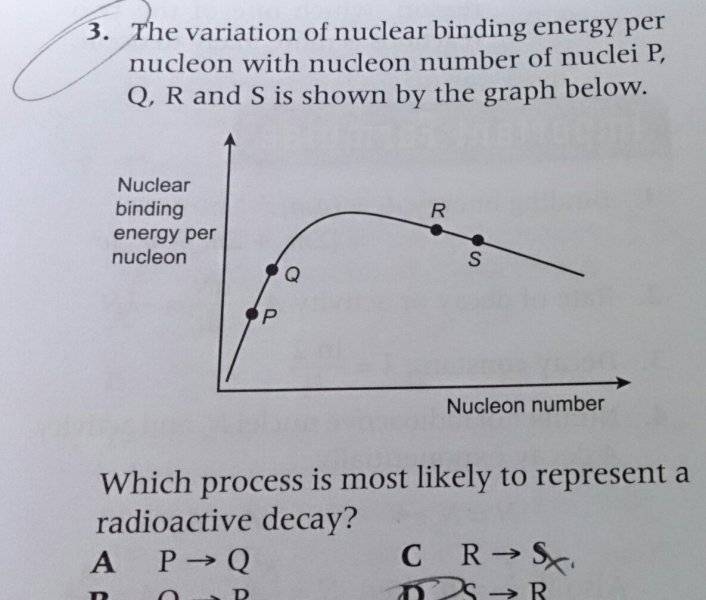

the variation of nuclear binding energy per nucelon of nuclei P , Q , R and S are shown.
Which process most likely to occur?
the ans is P to Q ... why not S to R ?
both
P to Q and S to R involve formation of unstable nucleus to more stable nucleus...
  • Graph of nuclear binding energy per nucleon against nucleon number, rising steeply then peaking and falling gently, with points P, Q, R and S marked; below it the question asks which process is most likely to be radioactive decay, with options A P to Q, C R to S (crossed out) and D S to R (circled).
1. Radioactive decay is the process fission. What will this do with the number of nucleons?
Your answer to this should tell you which way any likely reaction would go, either:
  • S ##\rightarrow## R and Q ##\rightarrow## P.
  • S ##\leftarrow## R and Q ##\leftarrow## P.
2. To achieve a more stable atom, that is a resulting atom with a higher binding energy, which way will the respective reactions go?
As soon as you know the answer to these two conditions, only one possible option will remain :)...
H.
To achieve more stable atom either p to q or r to s will occur...
I think you need to read my previous reply a bit more careful ;)..
Both 1. and 2. Has to be fulfilled.. Also, your statement about stability, are both correct? Remember, higher binding energy ##\rightarrow## more stable.
Do the problem actually mentions "radioactive decay"?
How is a decay in which the number of nucleons increases?
