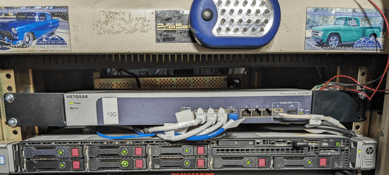

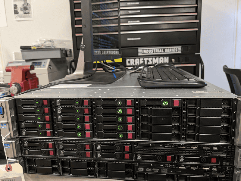

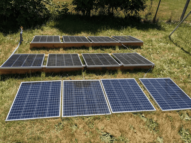

My case might not be typical as:
I run surplus enterprise servers (that have enterprise level raid error reporting and prediction) at home on a 10G house backbone that uses 24/7 off-grid solar power (battery bank)
for the computer rack and cooling.

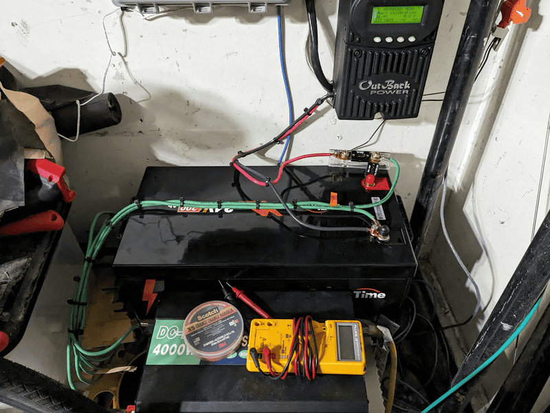

24V 200Ah LiFePO4 Battery with 4000W inverter.
Power system build pics.
A typical work related RAID 10 storage system
https://www.acronis.com/en-us/blog/posts/whats-raid10-and-why-should-i-use-it/

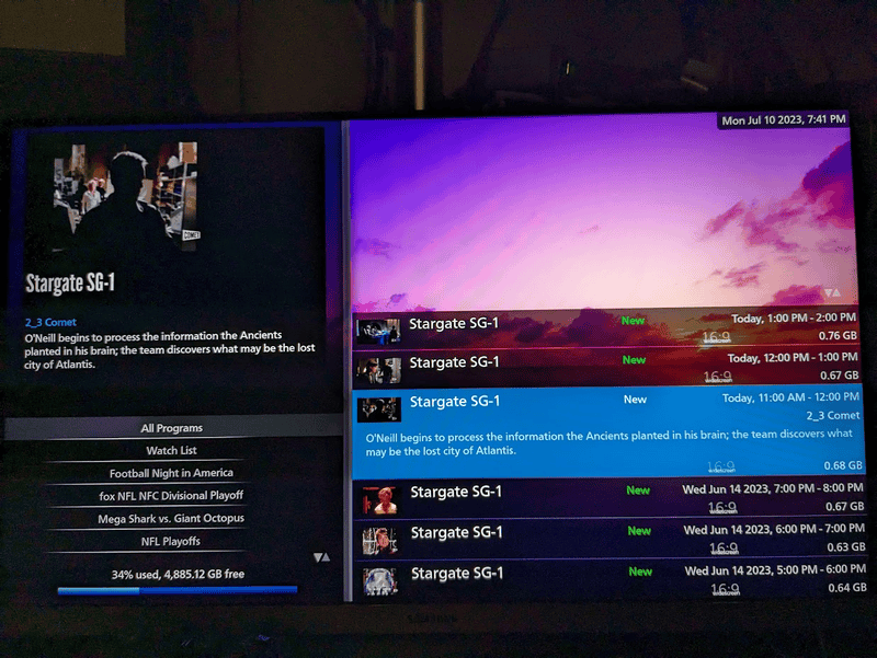

I think the DVR use case is probably the best for this. To first order, a show comes on, is recorded, is watched, and then erased. Yes, some programs are kept for a while, so this isn't exactly the case, but it's close.
It also means that the data is dominated by a few large files. Not sure of the impact of this, but it's certainly a feature.
I don't see speed as an issue. Typically, HD is about 1.6 GB/hour. I have four tuners, so my max write speed is 6.4 GB/hour or 15 Mb/s. (Note the switch to bits) That's tiny. As I said, read speed saturates the network, so I won't see any boost there.
Because of the caching structure, unless I have recorded a lot of shows without watching them, I am likely getting the data from memory, or at least my cache SSD. So the speed of the RAID array doesn't enter into it except for programs I recorded a long time ago and haven't watched and erased.
Remember, people used to "tape" shows - so the speed of magnetic tape was adequate.

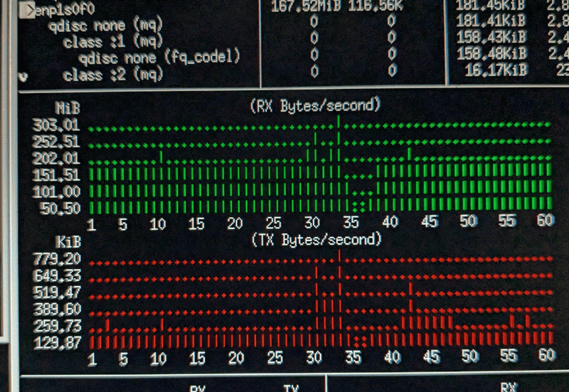

I have a DVR type recording system using MYTHTV, Zoneminder and a DLNA server that what writes/reads large program sized files via SAS HDD raid. Speed is not a problem with good hardware and a fast network. Linux XFS to XFS file system transfers on a 10G Ethernet backbone.
Bulk file transfer numbers.
