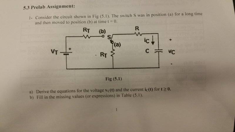

Question is attached below

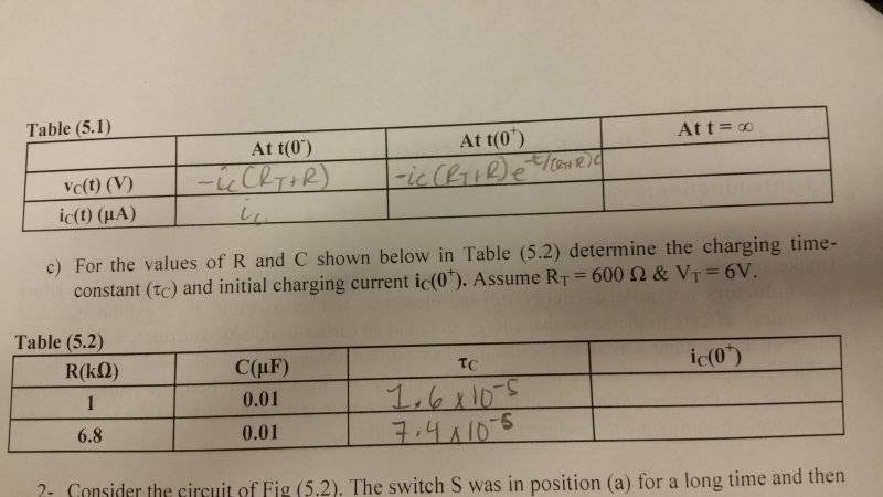

v(t) =v(infinity) + [v(t0)-v(infinity)]e^[-(t-t0)]
For t<0, you get the circuit where it is only Rt, R, and C, but in dc circuits, the capacitor is an open circuit, does this mean v(t0) =0?
For t>0 the middle Rt is removed and you get a circuit consisting of Vt, Rt, R and C. To find Rth, you short circuit Vt and open circuit C, so Req= Rt+R. So time constant is C(Rt+R). To find v(infinity), we open circuit the the capacitator, but how do you solve for v(infinity)?

How large a voltage do you need across the capacitor in order that the current from the battery to the capacitor is zero?

So far, what I know is that the voltage across the capacitor is zero when t<0. For t>0,the switch is in position b and the capacitor is an open open circuit do dc. This will result in equation:
-VT+(RT+R)*ic+Vc(t>0)=0
= Vc(t>0)=VT-(RT+R)*ic
Can someone help me please?
"At DC a capacitor appears as an open-circuit" holds true ONLY under steady DC when all currents and voltages have reached fixed, unchanging levels. You could say this occurs at t=infinity.
At switch-on when the capacitor voltage is not at its final fixed value, the capacitor for that brief instant appears as a short-circuit.

Hint: When the voltage across the capacitor (VC) is equal to the battery voltage (VT), what is the current from the battery to the capacitor?
Correct but...
a) What is the voltage on the capacitor at t=0 ?
b) What is the voltage drop across the resistors at t=0?
c) What is the current through the resistors at t=0?
d) What happens to the charge and voltage on the capacitor as a result of that current?
