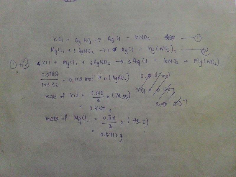

A mixture consisting of KCI and MgCl2 weights 1.2505 g. The mixture was
dissolved in water and an excess of AgNO3 was added. The chloride ions
were precipitated as AgCl. The mass of AgCl obtained was 2.5788 g.
Calculate the percentages of KCI and MgCl2 in the original mixture.

Sorry guys I'm stuck after calculating the moles AgCl , then I have no idea since both MgCl2 and KCl

First of all your 3rd chemical reaction is not correct, you cannot always add chemical reactions the same way you add equations in math.
Suppose x are the moles of KCI and y are the moles of MgCl2 present in the initial mixture that weights 1.2505g. What equation can you make involving x, y, the molecular weights and the total mass of 1.2505g?

as refer the photo https://www.physicsforums.com/attachments/13292854_474251089440635_868770269_n-jpg.101434/
AgNO3 + KCl ---> AgCl + KNO3 ...(i)
2AgNO3 + MgCl2 ----> 2AgCl + Mg(NO3)2 ...(ii)
mole of AgCl 2.5788g/143.28 = 0.018mol , Assume
since I 1 mol from Chloride from equation (i) and 2 mole from equation (ii) total 3 mole
mass of KCl 0.018/3 x 74.55g mol-1 = 0.477g
mass of MgCl2 0.018/3 x 95.2g mol-1 = 0.5712g
after calculating the mass 0.477g KCl + 0.5712g = 1.0482g but this amount is not equal to orginal mass .1.2505g

The correct way to think is that from 1 mole of KCl you get 1 mole of AgCl cause that's what (i) tell us among other things, hence from x moles KCl you ll get x moles of AgCl. But you ll get additional moles of AgCl from (ii). Can you express those additional moles in terms of y? The total moles of AgCl will be equal to 0.018

ermm..it is
1 mole of KCl = 1 mole of AgCl
(0.018-x) mole of KCl = 0.018 mole of AgCl
1 mole of MgCl2 = 2 mole of AgCl
1/2 (0.018-y) mole of MgCl = 0.018 mole of AgCl
or
x mole of KCl = x mole of AgCl
1/2y-x mole of MgCl2 =

Sorry can't follow what you doing here...i ve posted two questions one in post #9 and one in post #12, if you can successfully answer those questions you ll make two linear equations each one involving x (the moles of KCl) and y(the moles of MgCl2) . Then you can easily solve the system of those two equations to obtain x and y.
