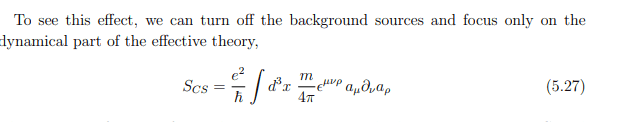

Hi

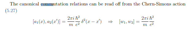

I'm sure i understood this a week or so ago, and I've forgot the idea now. I'm just really confused, again, how you read the commutator relationships of from the action ?
many thanks
(source http://www.damtp.cam.ac.uk/user/tong/qhe/five.pdf)

From the action, you read off the Lagrangian \mathcal{L} = \frac{me^{2}}{4\pi \hbar} \ \epsilon^{\mu\nu\rho} \ a_{\mu} \partial_{\nu} a_{\rho} . Now, calculate \frac{\partial \mathcal{L}}{\partial (\partial_{\sigma}a_{\tau})} = \frac{me^{2}}{2\pi \hbar} \ \epsilon^{\mu \sigma \tau} \ a_{\mu} . Now, setting \sigma = 0 and \tau = 1, you obtain the conjugate momentum \pi^{1}(x) = \frac{me^{2}}{2\pi \hbar} \epsilon^{012} \ a_{2} (x), or \pi^{1} (x^{\prime}) = \frac{me^{2}}{2\pi \hbar} \ a_{2}( x^{\prime} ) .The result follows If substitute this in the postulated canonical commutation relation \big[ a_{1} (x) , \pi^{1} (x^{\prime}) \big] = i\hbar \delta^{2} (x - x^{\prime}).
