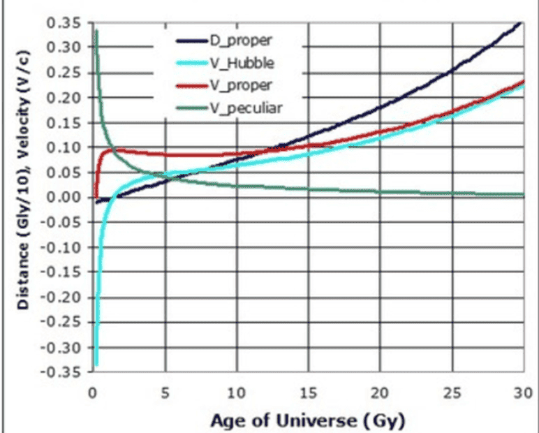

For what it's worth, I did this set of graphs a decade ago in an attempt to show, on an engineering forum, what things "look like" (taking Davis, Lineweaver, Webb at face value) for our standard model.
The object is 'untethered' at T=0.2 Gyr, at D_proper = -0.2 Glyr, with the distance scaled down to make it plottable on the scale of the velocities.
