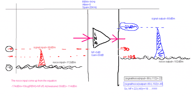

So today i did a simple experiment with an LNA . I so that the output noice power was not input +GAIN + NF ... i don't know why this...
Check the attached please
Not sure how you got -102dBm at output of amplifier, I calculate -109dbm (-111dBm thermal noise from amplifier + 114dBm from SA front end). This would give SNR of 49dB using amp and cascade noise figure of 4.8dB.
You don't calculate cascade noise figure by subtracting noise figure with and without preamp.
Dear friend can you please explain with details your calculations? i don't have a preamp.
i had signal generator----->S.A and then
Signal Generator-----LNA---->S.A just this.!
First let's figure out exactly what you have.
LNA is same as preamp.
Can you provide model number of the LNA? Are you sure it is 3dB NF?
Where did you get -102dBm, measured?
The noise you will see on the SA will consist of:
The SA thermal noise (-114dBm). Same as you would see if you terminated SA input with 50 ohms.
plus
The noise arriving through the LNA (which will be a "signal" from the SA perspective).
Its value is -174 +10log(1KHz) + 30 + 3 = -111dBm.
Convert these to mW, add, then convert back to dBm and you get -109dBm.

Hi again.
as you said we must think the system as a cascade.
---LNA with NF1,G1 ---- S.A NF2,G2---display screen
NFtotal=4.8dB
So Noiceout=-174dBm+10logRBW+NFtotal+Gtotal=-174dBm+30+4.8+(gaintotal??)= ?
This will show as the noice floor when we add an lna ..
But what is the Gain of S.A?
Also i was wrong. I Have a HP 8595A and there is NOICE MARKER :biggrin:
Sorry, I had not noticed that you responded back.
Glad you found your noise marker!
The spectrum analyzer gain is 1 (0dB). What you read on the screen is what it sees on its N-connector. For example, if you enable 20dB of SA internal attenuation, the screen does not drop 20dB. Software in the SA adjusts the display to compensate for any internal attenuation/preamp settings.
Using 0dB for SA gain:
So Noiceout=-174dBm+10logRBW+NFtotal+Gtotal=-174dBm+30+4.8+30= -109dBm

I did again the experiment so i notice that: the noise of S.A at RBW=1KHZ and 0 atten is: -113 to -123 not stable. With LNA added goes to -90dBm.
With noise market without LNA is:-149 to -150 dBm and with LNA goes to -128dBm.
Now is more clear what is going on ? i don't understand how this -128dBm goes out from noise marker but i think i must use noise marker because the simple market is not stable !
If you are not using the noise marker you should use RMS detector and turn on display averaging, otherwise the noise floor is quite jumpy.
Noise marker result is normalized to 1Hz bandwidth (regardless of your resolution bandwidth setting). In other words, do not add the [10log(1KHz) = 30dB] factor when using noise marker.

with noise market -150dBm. how this came from? -174dBm +NFs.a=-150dBm so the NF~24dBm? this is not right i believe. but how can i find the NF of my s.a to do the maths to estimate the NFtotal
Why do you think this is not right?
With your video averaging enabled does the marker go from -150dBm to about -120dBm when you turn noise marker off? (@ 1KHz RBW).
SA NF does depend on your center freq.
-150dBm noise marker tells me that your attenuation may be set to 0dB? This does give you better NF for spectrum analyzer alone, but normally you want to use -10dB (this is default) and good low noise preamp in front of it. SA amplitude calibration is done with -10dB attenuation and VSWR of SA input is unspecified with 0dB attenuation and may cause mismatch errors.

Hi ! i am confused because the NF of s.a is different with noise marker on and off?both attenuation 0dBm and 50 ohm terminal at s.a input.
1)with noise marker on; -150dBm/hz=-174+NFs.a => NFs.a=24dBm ?
2)with noise marker off: -113 dbm = -174 +10log(RBW=1KHz)=30 +NFs.a=>NFs.a=30dBm...?
OR -123dbM=-174DBm +30+NFS.A=> NFs.a=20dBm... ?
which one is real ?

Use the noise marker, that is what it is there for.
The reason the SA provides the noise marker is to compensate for various errors which arise when simply viewing the noise floor on the screen (DANL):
1 - Noise is an RMS measurement. 859X series use envelope detector, not an RMS detector. This causes under response of about 1dB.
2 - 859X series performs averaging of the output of the log amp. For proper noise measurement averaging should occur before log amp (log of the average is not equal to average of the log).
This causes under response of about 1.5dB.
3 - 859X series uses resolution BW filter that is not a brickwall filter. Noise measurements are normalized to a 1Hz brickwall filter. This causes over response of about 0.5dB (brickwall filter captures 0.5dB less noise power than RBW filter of same 3dB bandwidth.)
Thus we expect a net ~2dB lower DANL vs. noise marker which is what you are seeing.
Your -113dBm reading (without noise marker) is probably because you have 10dB attenuation turned on. This is the SA default. Make sure attenuation is on manual (not auto). BTW you should be using 10dB attenuation as I mentioned in my previous post, particularly since you have a preamp.

So many thanks about your help friends. It is so important really thanks!
So about my experiment i want to measure S/N .. about the noise ,activate noise marker on and what setting maybe i will make to be close to theory?
RBW=20KHZ ?is this good or larger or smaller ?my signals's bandwidth is 20khz
please check my attached
