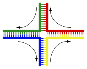

Do you know what a Holliday junction is? I think that concept violates your point of view. It means that the two ends are swapped at one point. One crossover, one point, not two.
