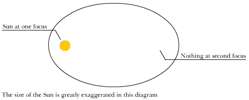

How does an ellipse defined by two foci relate to an ellipse defined by one focus?
An ellipse is a conic section - a slice through a cone. The axis of the cone coincides with the focus of the ellipse.(Correct?)

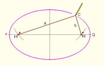

But ellipses can have two foci, not just one, as shown by this method of construction:
Ellipse drawn with two foci F1 and F2 on its horizontal axis, labelled P and Q at the ends. A string from F1 to a point C on the curve and from C to F2 is shown, with segments labelled a and b, and a pencil-like tool at C tracing the curve.
Questions:
1. Is F1 in the diagram the same as the axis of the conic section?
2. Does F2 have any correlation in the conic model?
3. Is there some way that these two apparently unrelated definitions of an ellipses are two sides of the same coin?

I didn't realize the focus of an ellipse is the axis of the cone, cool fact.
If you take a fixed plane, you can take an angled cone and intersect it with the plane to make an ellipse. If you reflect the cone, you can get the same ellipse with that other cone. I think that second cone gives you the second focus.
There's a very good video from 3B1B proving the equivalence of the two ellipse definitions:

An ellipse can not be defined only by one focus. There must be additional information to define an ellipse and that is also enough to determine the second focus. The solar system is an example of this. The Sun is a single focus, yet there are many planets orbiting it along different elliptical paths. So the next question is what additional information are you willing to specify? We need to know that before we can answer how the second focus can be determined.
I see that you are asking if the definition of "focus" is the same for both definitions of an ellipse. Do you have a reference that defines "focus" and "axis" as you are using it?
The axis of a cone is through the center of the cone and it does not coincide with the Sun's location.
Yes. I should have said 'has a only single focus as part if its definition'.
Indeed. My guess was wrong.
Alas. T'isn't. Check out the excellent video posted by @Gaussian97 , above, at timestamp 4:17.
Thanks guys.
Esp. @Gaussian97 for answering the question in one swell foop.
