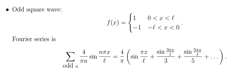

is this a reverse square wave?
the series looks similar to this?
  • Typeset math: odd square wave f(x) equals 1 for 0 < x < l and -1 for -l < x < 0, with its sine Fourier series sum over odd n of (4/(pi n)) sin(n pi x / l) equal to (4/pi)(sin(pi x/l) + sin(3 pi x/l)/3 + sin(5 pi x/l)/5 + ...).
