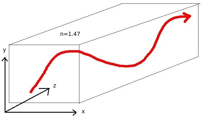

Hello All, this is my first post, and while I'm a newb to the forums I'm not a newb to Optics. However, I have a very light background in low level electromagnetics, I'm more of a network design person.
I'm working on a very very long term personal project to understand optics better and I've come to the point where I would like to understand how to calculate how an EM-Wave propagates down a Rectangular Optical Waveguide. This waveguide is made of one glass material "n=1.47", it has nothing but air surrounding it. "See the attached image"
If I take the standard wave equation of:
[tex]{ \partial^2 u \over \partial t^2 } = c^2 \nabla^2 u[/tex]
and I calculate that the speed of light in the medium "with a refractive index or n=1.47" is
[tex]c = { c_o \over n } = { 1 \over \sqrt{ \mu \varepsilon } }[/tex]
which equals: 203945578.23
What's my next step?
Am I even going in the right direction?
both Jackson and Griffiths (and probably every EM book ever written) have sections on waveguides, and in particular on rectangular waveguides like the one you are interested in... I would probably start with Griffiths if I were you:
Griffiths, "Introduction to Electrodynamics", section 9.5 (Guided Waves), especially section 9.5.2 (TE waves in a rectangular Wave Guide)

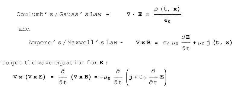

Ok, I've got to go back to the basics again:
Can you explain curl?
as in how do I do it, I've read many portions of many books that say by taking the curl of Maxwell's equations 2 and 4, we can derive the Wave equation for E. However I don't understand how they get from this: "See the attached"
"Curl" can be thought of as a differential operator that acts on vectors it's also written with the nabla [tex]\nabla[/tex] and cross-product [tex]\times[/tex] symbols as
[tex] curl\vec V=\vec \nabla\times \vec V[/tex]
I.e., curl V is a vector whose cartesian components are given by
[tex] (curl V)_x=\frac{\partial V_z}{\partial y}-\frac{\partial V_y}{\partial z}[/tex]
and
[tex] (curl V)_y=\frac{\partial V_x}{\partial z}-\frac{\partial V_z}{\partial x}[/tex]
and
[tex] (curl V)_z=\frac{\partial V_y}{\partial x}-\frac{\partial V_x}{\partial y}[/tex]
...now, you get to start memorizing properties of the curl. For example, since the curl of a vector is also a vector you can take the curl twice. For example:
[tex] \vec \nabla \times (\vec \nabla \times \vec V)\;.[/tex]
It turns out that that is equal to
[tex] -\nabla^2\vec V+\vec\nabla(\vec \nabla\cdot\vec V)[/tex]
So, for example, it you have [tex]\vec \nabla\cdot \vec V=0[/tex] (like if V was a magnetic field) then you would have
[tex] \nabla\times\nabla\times\vec B=-\nabla^2\vec B\;.[/tex]
Low and behold there is the spatial part of a wave equation!
... but from maxwell's equation we also know that (in the absence of sources)
[tex] \nabla\times B=\frac{\partial E}{c\partial t}[/tex]
and [tex]\nabla\times E=\frac{\partial B}{-c\partial t}[/tex]so that
[tex] \nabla\times\nabla\times B=\nabla\times\frac{\partial E}{c\partial t}=-\frac{\partial^2 B}{c^2\partial t^2}[/tex]
Low and behold, the other half of your wave-equation. Thus all together we have:
[tex] -\nabla^2\vec B=\frac{\partial^2}{-c^2\partial t^2}\vec B[/tex]
...we can look for solutions to maxwell's equation that are traveling waves whose velocity is c.
