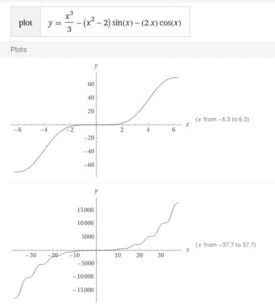

I tried
[tex]=-2\pi V_0 A^2 \int_0^R (1- \cos 2k_1r)r^2dr[/tex] [tex]=-\frac{\pi A^2}{4k_1^3} V_0 \int_0^{2k_1R} (1- \cos y)y^2dy[/tex]
[tex]=-\frac{\pi A^2}{4k_1^3} V_0 \{ \frac{u^3}{3}-(u^2-2)\sin u -2u \cos u \}[/tex]
where
[tex]u=2k_1R[/tex]
Though I am careless in calculation, do you share it with me ? Does it have anything good to you ?
Normalization factor A is also a function of k_1 , k_2 and R. We may have to get it for full investigation.
This is what I get without evaluation from 0-R.
