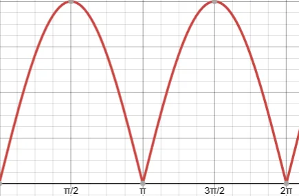

Fig: Full bridge rectifier output

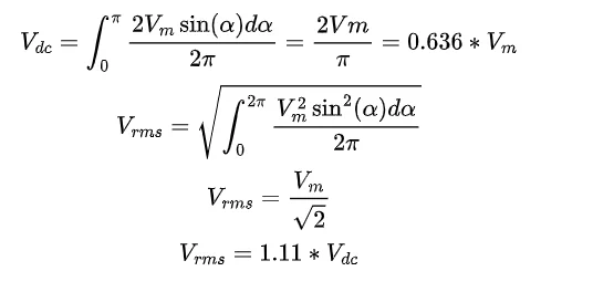

I calculated above parameters for full wave bridge rectifier, so if Vm of the sine wave increases/decreases the Vdc changes accordingly and the Vrms.
The corresponding current is
Beyond this i am unable to understand the 1mA and full-scale reading. Converting from voltage to current, current to voltage all messing up.

Vrms = 1.11 * Vdc = 1.11*5.01 V = 5.56V
Correct.
Vrms / Vdc = ½ ⋅ π / √2 = 1.11072
