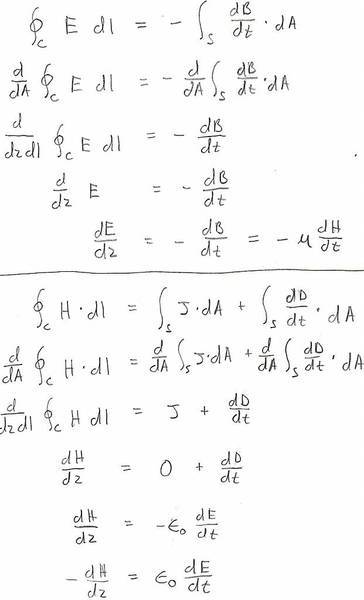

Okay. This is my work. I started with the Integral form because that actually seemed easier. That's the reverse of what I said before. I was looking at different Maxwell Equations from my Physics book when I arrived at that conclusion. I'm not sure if I'm making a legal step when I set d/dA = d/(dz*dl). The work is on a *.jpg attachment to this post. I'm not sure how to introduce the negative sign to the dH/dz equation. I decided that the epsilon 0 constant must be negative and that is how I introduced the negative sign on one side of the equation.

One thing I failed to mention is how I concluded that J = 0. J is defined on the wikipedia website I mentioned earlier as the free current density. I interpretted this to mean the current flowing between the two electric lines. These two electric lines are not necessarily connected so the free current density is 0. Maybe I'm interpretting this wrong. Maybe the free part means electricity flowing through air. Making some assumptions I can guess that it is zero so that the J becomes zero. I think this goes back to the question you had earlier mav.
\epsilon_0 cannot be negative.
It is a fundamental constant. Recall that you can write it as:
\epsilon_0 \mu_0 = \frac{1}{c^2}
So you can conclude that neither \epsilon_0 or \mu_0 can be zero.
EDIT: Actually you can't reach that conclusion alone. Since both epsilon_0, and mu_0 can be zero, and still satisfy that equation. Just note, that it can't be zero.
Hi, sorry for the late reply. I had a look at your work. I think you should start with the differential formulation of the Maxwell's equations (you'll get the same equations, but its more obvious what's happening that way). I am not convinced about the operator
\frac{d}{dzdl}
This is what you probably meant:
\frac{d}{dt}\int f(x,t)dx = \int \frac{\partial f(x,t)}{\partial t}dx
or
\frac{d}{dx}\int f(x,t)dx = f(x,t)
Or if you write the da explicitly and write the double integral, then you will have to operate the derivative twice. Effectively you would be doing this: d^{2}()/dzdl.
Do you see what I'm saying here?
Start instead with the differential form of Maxwell's equations (curl and divergence)...work from there.
