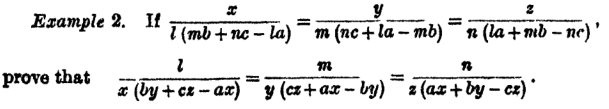

If $$\frac{x}{l(mb+nc-la)}= \frac{y}{m(nc+la-mb)}=\frac{z}{n(la+mb-nc)},$$
prove that $$\boxed{\frac{l}{x(by+cz-lz)}= \frac{m}{y(cz+ax-by)}=\frac{n}{z(ax+by-cz)}}$$

Problem statement : Let me copy and paste the problem as it appears in the text :
Attempt : I am afraid this looks like a very difficult problem, despite being at the elementary level (high school). My glance through the text shows that the authors have gone about reducing the first set of fractions to the second directly, without making the (traditional) use of the auxilliary variable ##k## to which the whole of the first list is first equated to and then simplified. Let me go with this method.

Doubt : So I did the problem. However, as you have noticed, I have made use of the auxilliary variable ##k## above, which I equated all the fractions to. Does anyone know a way by which the fractions given can be directly reduced to those required? (That is the method asked for by the authors before the problem).

I post the solution below as given by the authors. It is incredibly well done and, needless to say, very difficult. I struggled at several places to understand what the authors were doing, let alone try and do it myself !
