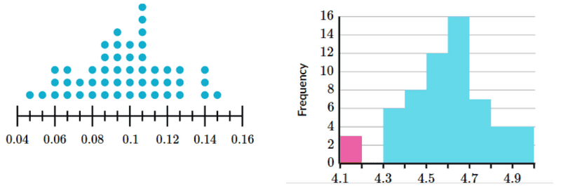

That's not the only question with a sample that fails the successes ##\geq 10## and failures ##\geq 10## test. Actually there's only ##1## other question, but this time we're checking for mean. @Dale , do you know if there's an interactive website with a Monte Carlo simulation?
I believe the point to note is this is a simulation of a sampling distribution of sample proportions. Could it be that the condition, the distribution of the sample is uniform (no outliers, etc.?). It feels right to me to conduct a simulation in this way, with the simulation sample size = whatever the sample size was initially.
These are the sampling distribution of the sample proportions. Would you agree that the distribution is roughly normal and SO we don't have to concern ourselves with sample size being inadequate to satisfy the succeses ##\geq 10## and failures ##\geq 10## condition for inference.
This is not the distribution of proportions for a sample size of 8. For a sample size of 8 the possible proportions are only integer multiples of 0.125, and between 0 and 1.
I agree. Unless the simulation were intended to explore “what if” for different experimental approaches.
Apologies. Got lost in the woods. However, these are from similar questions, where the sample size is too small for the conditions for inference to be satisfied.
Would you agree that if the distribution is normal, we can ignore the small sample size?
No. The inferences will be unreliable. Even if it looks more or less normal the mean and standard deviation will not be reliable.
By the way, in my simulation I did not make the normal approximation. I used a binomial distribution. So if their simulation used the normal approximation that could be an issue.
