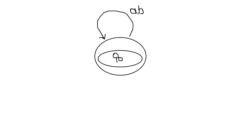

Is it maybe like that?View attachment 1782

That's correct. In general, finite languages (including the empty one: no accepting states) are regular, and the class of regular languages is closed under complements. Thus, if a language has a finite number of words (including 0) or if a language is $\Sigma^*$ without a finite number of words (in particular, $\Sigma^*$ itself), then it is regular.
