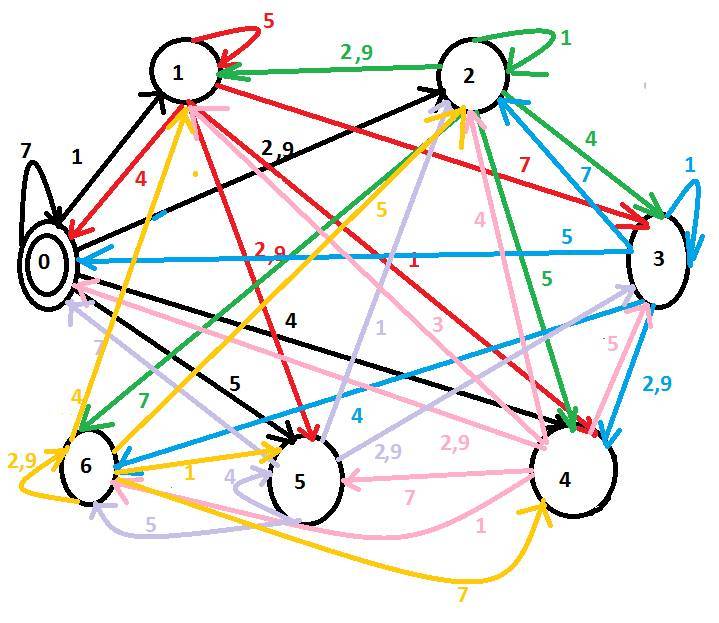

I thought that I could show that the language is regular,drawing a DFA,which states are all the possible remainders..Is this right?
Could I also do this,without the use of a DFA? :confused:

I just can imagine that the final state of the DFA should be the one with $\text{remainder}=0$,but I don't really know which other transitions there could be.. :confused:

Each transition would correspond to the next digit on the input.
Each state would correspond to a remainder...

We can start at the state with remainder 0, corresponding to the empty symbol.
This state would also be the final state, since we would have a number that is divisible by 7.
Then, after an 1, we can go to the state with remainder 1.
From state 1, a 2 would bring us for instance to the number 12, which has remainder 5.
So a 2 would bring us from state 1 to state 5.
Perhaps you can draw something? :o

I have tried to draw the DFA.I hope you can distinguish what I have written :o
Is it right?

Aha!
I like the colors! (Cool)
Looks good... except for that arrow from 4 to 1 that has a 3 attached to it.
I believe 3 is not part of the alphabet. :eek:

I understand... thank you very much! :)
