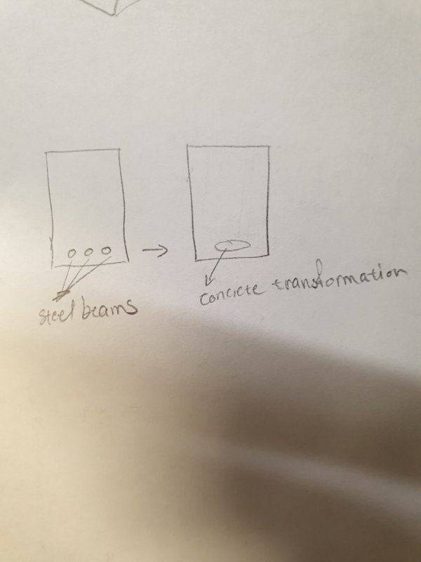

The discussion centers on the transformation of multiple steel beams into a single piece of concrete for the purpose of calculating the second moment of area. It is established that while it may seem reasonable to combine the beams into one concrete piece, this approach requires careful consideration of the material properties and structural design principles. The book "Reinforced Concrete Design" by Spiegel and Limbrunner is recommended for in-depth analysis, particularly regarding the distinctions between balanced, underreinforced, and overreinforced beams. The transformation also involves understanding the Young's Modulus ratio between steel and concrete.
