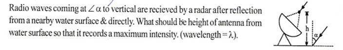

The path difference between the two rays being received by antenna is ##h/cos(\alpha)## but how to relate the path difference with the intensity?
  • Printed problem text: Radio waves coming at angle α to vertical are received by a radar after reflection from a nearby water surface & directly. What should be height of antenna from water surface so that it records a maximum intensity (wavelength = λ). Beside it, a diagram of a dish antenna at height h above water, with ray arriving at angle α.

Phase difference is equal to ##2n\pi## or path difference is ##n\lambda##.
Correct. So you need n*lambda path difference. Solve for h?
What is the value of n? :confused:
I end up with ##h=n\lambda \cos \alpha##.
n can be any positive integer. Are you sure that you got the correct expression for the path difference? Did you take into account the law of reflection? I wonder if you are meant to include a phase shift due to reflection?
Do you want to make the height higher than it has to be? You can make it ##h=\lambda \cos \alpha## or ##h=2\lambda \cos \alpha## or ...
I would make it as low as possible while satisfying your equation! :smile:
I don't know about considering the phase shift. There is nothing mentioned in the question about it. I think I got the right expression for path difference considering no phase shift. The given answer is ##\lambda/(4\cos \alpha)##.

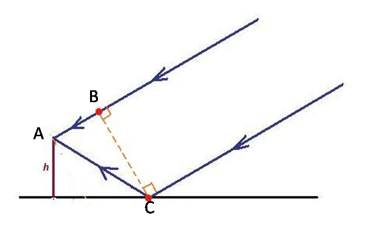

The light reflected from the surface of water which reaches the antenna has to travel an extra distance of ##h/\cos \alpha## (which can be easily calculated from simple trigonometry). This is the path difference. What have I done wrong? :confused:
The two waves travel the same distance to the red dots shown in the figure.

Sorry for the late reply.
The length AC is ##h/\cos \alpha##.
##\angle ACB=2\alpha-\pi/2##
##\sin \angle ACB=AB/AC=AB\cos \alpha/h \Rightarrow -\cos 2\alpha=AB\cos \alpha/h##
##\Rightarrow AB=-h\cos 2\alpha/\cos \alpha##
Am I doing this right?
  • Geometry diagram of two parallel rays hitting a horizontal line, one reflecting at point A at height h and the other at C, with B on the incoming ray and dashed segment BC marked with right angles.
TSny said:
Yes, that looks ok.
Path difference is ##AC-AB=\frac{h}{\cos \alpha}+\frac{h\cos 2\alpha}{\cos \alpha}##
[tex]= \frac{h(1+\cos 2\alpha)}{\cos \alpha}=2h\cos \alpha[/tex]
The path difference should be equal to ##n\lambda## and for min height, ##n=1##
[tex]\Rightarrow h=\frac{\lambda}{2\cos \alpha}[/tex]
But this is wrong. :confused:
That all looks good. You might be expected to include a phase shift of the wave that reflects off the water.
If I include the phase shift, I do get the right answer. Thank you TSny! :smile:

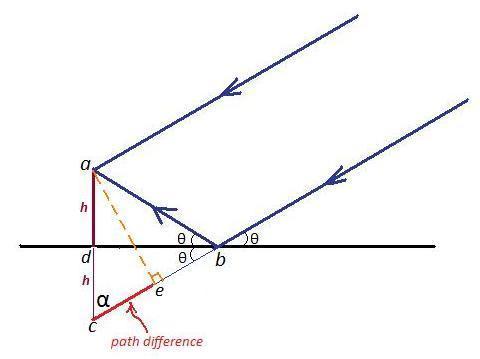

There's a trick that can make finding the path difference easier. In the figure, the tower is extended a distance h below the ground. You can use the law of reflection to show that the triangles abd and cbd are congruent. Then ba = bc and ec is the path difference.
  • Diagram of two parallel rays reflecting off a horizontal surface at point b, with angle theta marked; point a is h above the surface and point c is h below, with the path difference segment ec marked in red.
That makes it a lot easier, thanks! :cool:
