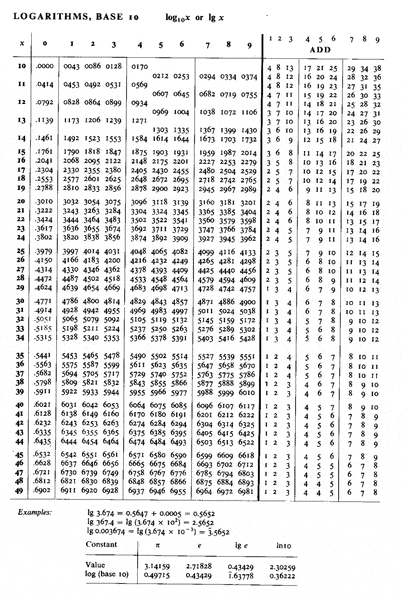

log10e = 0.4343
(so 100.4343 = e)
(and if you look at the top line of your log tables, you'll see it starts 0043 0086 etc, which is short for 004343 …… oooh, do people still have log tables? :redface: see
Yes, they do.

tiny-tim said:
log10e = 0.4343
(so 100.4343 = e)
Ah yes this makes sense, thanks tiny-tim!
