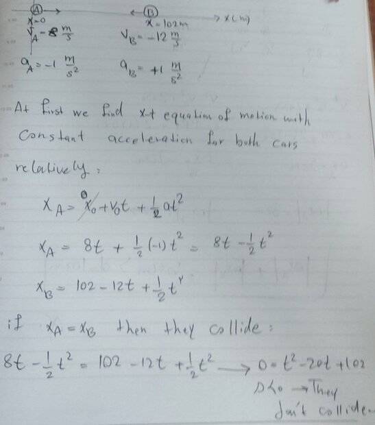

Two cars A and B are moving towards each other with speeds of 8m/s and 12m/s respectively. When the distance between the two cars is 102m, both drivers brake at the same time. If both cars decelerate with an acceleration of 1 m/s², how many seconds after the moment of braking will the two cars hit each other?
X=X0+V0t+(1/2)at^2
I think the question is wrong.
My answer :
Handwritten physics working on lined paper: two cars A and B on an x-axis, with equations of motion for each car, setting x_A = x_B, and the quadratic 0 = t^2 - 20t + 102 concluding they don't collide.

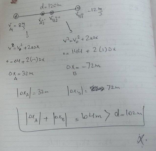

But it should be wrong because :
Handwritten working on lined paper: a line from A to B labelled d = 120 m, with v_A1 = 8 m/s and v_B1 = -12 m/s; kinematic steps v^2 = v0^2 + 2aΔx giving Δx_A = 32 m and Δx_B = -72 m, then |Δx_A| + |Δx_B| = 104 m > d = 102 m, with a cross mark.
I think the question is wrong … But I'm not sure …
The acceleration of B can’t be positive; its velocity is never increasing.

According to the question, the motion is decelerating.
So the sign of speed and acceleration of car A must be different. The same for B.
I observed this for both cars A and B. Could you please tell me where my mistake is ?!

Since they are initially at different speeds but decelerating at the same rate, they will not come to a stop at the same time. So you need to think about what happens when one car stops. You can’t assume it maintains the same acceleration.
I've founded my mistake.
Thank you for your time.

I think the answer is 10 seconds.
I think so too. The first car stops after 8 seconds, having traveled 32 metres. The second car travels 70 metres in 10 seconds.
