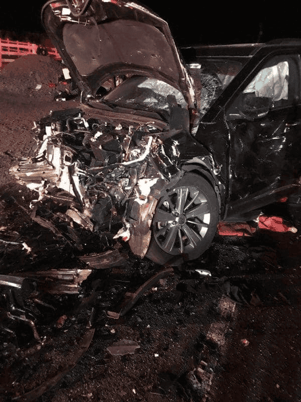

And here is a picture of a head-on crash from last Sunday night where my 12 year old granddaughter was riding in the car, coming back from a weekened with her friends. Everybody in their car survived with only moderate injuries (the person who caused the crash in the other vehicle was not wearing a seatbelt, and was ejected and killed). Do you think the safety rating of this car was important?
OMG! Thank goodness those kids were ok. That’s as graphic a demonstration as you can get.

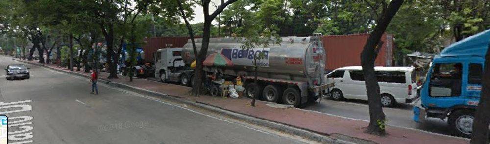

If the 18-wheeler big rig truck pushed the other party car at stop. How come the person was ejected outside in the windshield when the speed was low?

I don't have the full story yet, but the car my granddaughter was traveling in was going at freeway speed when the impact happened...

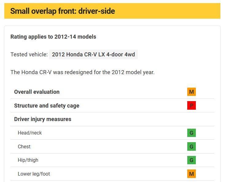

My car is Honda CRV 2004 model. Here is the IIHS rating.
https://www.iihs.org/ratings/vehicle/honda/cr-v/2004
At that time there was no small overlap front tests done yet. It's only done in the CRV 2012 model and onwards. It has Marginal score in the 2012 to 2015. This means the models prior has marginal scores too.
It's only beginning in 2016 model where it has Good score. This means both your daughter (perhaps 2013 model) and my car (2004 model) has similar performance in the small overlap front: driver-side test where lower leg/foot is marginal. Any ideas what to do about it?

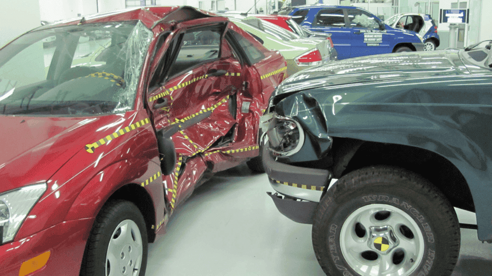

They added it in the 2005 model. Mine has no side impact airbags. Side impact bag is really very important? Are there studies about performance of cars with it and without it in side collisions? What is meant by T-bone collision?
A T-bone collision is when one car crashes into the side of another car, especially hitting the side doors directly. Older cars have little protection against this type of collision, and that exposes the driver or passenger to a very sharp side impact. In addition to breaking the hips and ribs, it usually causes a very severe head impact on the window, which often leads to a fatal brain injury. Not good.
IMO, the higher the IIHS rating the better (and hopefully you can find an appropriate brand/model of car which won't be too much of a target), but side impact airbags are now a requirement for me in any vehicle purchases. T-bone collisions are the worst that I see now in terms of injuries, when there is no side airbag protection.

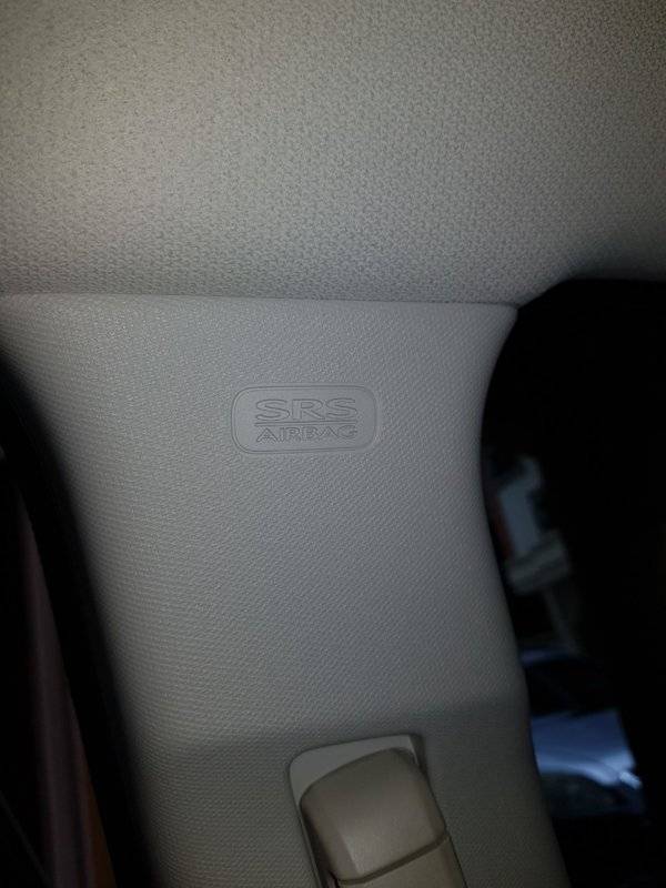

This is the side airbag of my parent new car with 7 airbags (we live in same house so I can use it since they don't use it anymore).

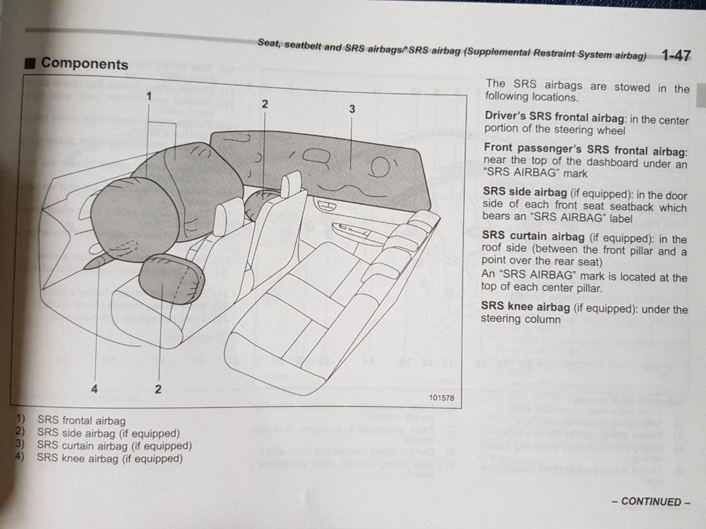

The small black label with texts at the side says "SRS Airbag". Do you think it can deploy with all the fabric and sews enclosing it?
Also this is the typical 7 airbags in new car (the 7th one is in the knee). Note the side air bag is small and just protect the torso and pelvis. I think the most important is the curtain airbags, right? For cars without it. Won't it be possible to add curtain airbags?

If there is no way I can add the side curtain airbags to existing old CRV. I have no choice but to get rid of it and buy a cheaper car with curtain airbag as backup to my parent car. We need a 2nd car other family members need to use them. What is the cheapest car with reliable curtain air bags now?

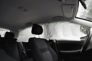

It looks like the "curtain" aibags are the ones that protect the occupants' heads in side collisions, so yes, that is an important feature IMO. It's not possible in general to retrofit older cars with new airbags, although you often can upgrade the seatbelt systems (for car racing, for example).
https://auto.howstuffworks.com/car-driving-safety/safety-regulatory-devices/side-curtain-airbag.htm

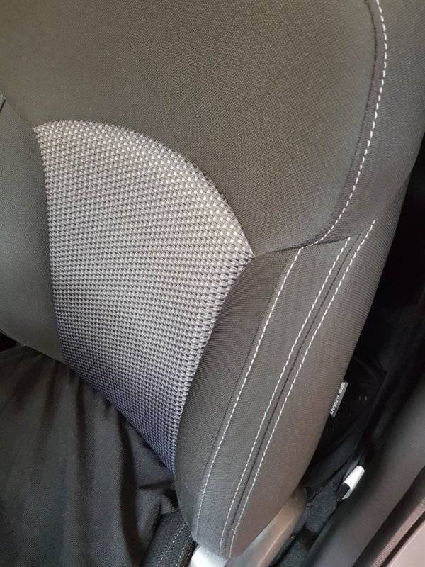

To those with lower side airbags that protect the torso and pelvis. Try to see if your seat cover is like this with cover? Can it really deployed with the cover on? Or do you remove all coverings for sure deployment?
For the curtain airbags of my parents car. It's located in the upper frame and no covers so no problems.
No, please don't try to tamper with any of the airbag systems. That could end badly several different ways...
new6ton said:
This is the side airbag of my parent new car with 7 airbags...The small black label with texts at the side says "SRS Airbag". Do you think it can deploy with all the fabric and sews enclosing it?
Yes. Have you ever seen an airbag deploy? It won’t even notice that bit of fabric and stitching.

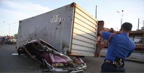

Is there any existing SUV that can survive fall from a container? Or should I need military milspec vehicle? And what military vehicle can survive it (just to know how the cage is designed)?

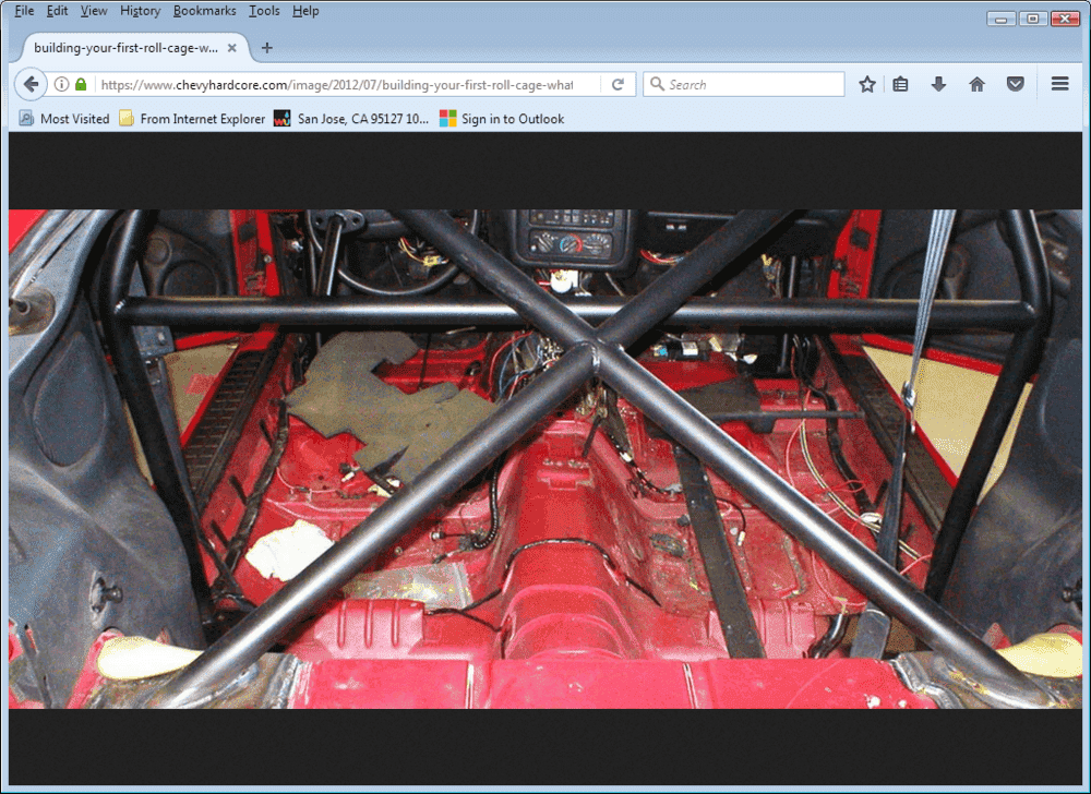

OCR said:
Car cage with 40% boron alloy used in Abloy padlock may be very strong. See:
But can it survive a container drop?
Also to make car absorb collision energy. It should not be rigid. So how do you draw the line between the cage so rigid to survive container fall and flexible enough to absorb collision energy? Who are car mechanical experts here?
Hopefully that doesn't happen very often where you live...
Your best option is probably to talk with a race car shop to see what kinds of vehicles they can build roll cages in. They are routinely installed in vehicles that folks take to racetracks for track days and club racing. I've seen them installed inside BMWs and Subarus, for example. They aren't cheap, and take up a fair bit of room inside the vehicle, but definitely make the car a lot stronger for rollovers (and container impacts, I guess)...
