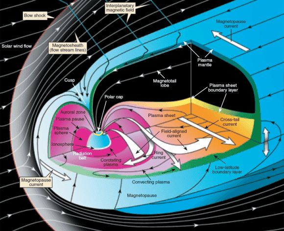

As for unexplained Auroral mechanisms, no good explanations exists as yet for "poleward arcs" stretching sunward across the polar cap, the related "theta aurora", and "dayside arcs" near noon.
Some new experiments, both in the lab and in space, have come along to add to this knowledge. Magnetic energy is seen to be converted to particle energy over spatial scales that greatly exceed previous theories and simulations. Theta aurora appears to be explained. The MMS mission is now underway to expand this knowledge.
http://www.nature.com/ncomms/2014/140910/ncomms5774/full/ncomms5774.html
http://www.nature.com/nphys/journal/v8/n4/abs/nphys2249.html
http://www.sciencemag.org/content/346/6216/1506
http://www.universetoday.com/117503/solved-the-mystery-of-Earth's-theta-aurora/
http://cadair.aber.ac.uk/dspace/bitstream/handle/2160/14316/Observation_of_double_layer_in_the_separatrix_region_during_magnetic_reconnection.pdf?sequence=2[/URL]
http://www.pppl.gov/news/press-releases/2014/09/pppl-scientists-take-key-step-toward-solving-major-astrophysical-mystery
[ATTACH=full]176837[/ATTACH]
Illustration of the Earth’s magnetosphere showing it complexity. The Theta Aurora are now confidently linked to magnetic reconnection events in the lobes of the magnetotail. (Credit: NASA)
The science paper explains that what was previously observed by only lower altitude spacecraft was captured by Cluster within the magnetotail lobes. The southerly lobe’s plasma – ionized particles – was very energetic. The measurements revealed that the southern lobe of the magnetotail was acting as a bottle and the particles were bouncing between two[URL='http://en.wikipedia.org/wiki/Magnetic_mirror']magnetic mirrors[/URL], that is, the lobes were close due to reconnection. The particles were highly energetic.
