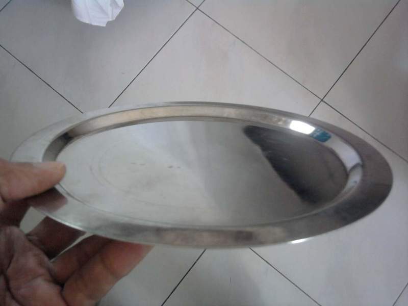

ok, here's the problem.
I've got a pan stuck (horizontally) flat inside a pressure cooker and I just can't get it out. The outer circumference of the pan is exactly the same at the inner circumference of the pressure cooker and I have things under this pan which I was heating in the pressure cooker.
The pan is just about 1mm thick but it's real tough and can't even bend.
Here's 2 pics, one showing the pan stuck in the pressure and the other showing a similar pan.
I've tried to pluck out, hammer out, etc., the pan but it only made things worse.

If you somehow can heat the outer cooker while (if possible) keeping the pan cool you may be able to get enough slack to get the pan out. However, since the cooker is conic (sloping sides) you should probably heat it up-side-down or the pan will just get even more stuck.
Looks like you've got it jammed in there pretty good. I would try heating the pot, then pouring some cold water on the pan to create a bit of slack. Be ready to pry it out (use a hook, if you have room) if you are able to get some slack.

I tried heating the pressure while placing large amounts of ice on the pan and I managed to get a hook in between the 2 so I could try to pull the pan out (and prevent it from sinking in deeper) but no luck. In a very short while the ice started to melt.
If you're able to get water in the gap around the inner one then you could try filling that with some water and boiling it to try and create some pressure to help push up on the trapped one perhaps?

There seems to be a gap between the sides of the pressure cooker and the pan.Pour water in so it goes through the gap and fills the space between cooker and pan.Now put the whole thing in the freezer so that the water freezes and hopefully pushes up the pan.
I like the idea of passing water through the gap, but if I were to freeze or boil, wouldn't the water expand and escape from the gap?

It would depend how big the gap is, if it is comfortable for the steam to escape out through then it might not be of much use, I don't think freezing would work because of how the density of water works at near freezing temperatures, I think that water will flow straight back out of the hole before it actually freezes...

Guys, I've tried horse-shoe magnets and even the dc-vibrator but no luck. I guess the pudding in there may have turned to super glue or something and that's causing such a jam.
Now the final try - as DadFace and DaveC426913 have suggested - filling the pot with water and freezing. Let's see after 24hrs (wondering if 24hrs is enough for such volumes of water) otherwise I'll have the lid grinded - in both ways, there's no pudding.

Yea, I'm liking the ice idea. Since ice freezes top-down, I don't think you'll have an issue with water escaping through the gap.

I have been able to loosen shafts when stuck inside a cylinder by using two hammers, hitting the cylinder at diametrically opposite sides of the cylinder (e.g. stuck bicycle pedal cranks). This will cause the outer cylinder to flex, minutely and briefly, into an elliptical shape. The distortion tends to break the adhesion between the inner and outer surfaces which were stuck together.
I have even used it successfully with a glass bowl stuck inside another glass bowl - hitting with two wooden rolling pins! The minute distortion was enough to release the jammed article. It was in a coffee shop / kitchen supplies shop and this flash of brilliance earned me a free cup of coffee!
