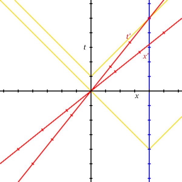

Sample Diagram with Variations
Here is the sample problem:
Let Bob and Ted be two observers four light years apart and at rest. Let Alice be an observer on a path from Bob to Ted at a constant velocity of 0.8 c. When Alice reaches Bob, Bob’s and Ted’s clocks read 0 (relative to either Bob or Ted). Alice’s clock also reads 0 (relative to Bob and Alice). Ted sends a light signal to Bob at Ted’s clock time of -4 years. Bob sends a light signal to Ted at Bob’s clock time of 1 years.​
Keep in mind that the various scripts that follow have not been tested since the tool doesn’t yet exist. The diagrams were drawn with my gen 1 version 1 tool and may also have errors. Since I can’t do animation, I capture one moment in time and then use arrows to indicate what’s moving. The final variation is too tough for me to even try to draw.
let bobColor = [style color: black];
let tedColor = [style color: blue];
let aliceColor = [style color: red];
let lightColor = [style color: yellow];
let textStyle = [style font: “Georgia”, slant: italic];
let bobStyle = [style bobColor, textStyle];
let tedStyle = [style tedColor, textStyle];
let aliceStyle = [style aliceColor, textStyle];
let bob = [observer ];
let ted = [observer origin (4, 0)];
let alice = [observer velocity 0.8];
let signal1 = [line angle -45 point (4, -4)];
let signal2 = [line angle +45 point (0, 1)];
axes frame: ted, x: false, tedStyle;
axes frame: bob, xLabel: “x”, tLabel “t”, bobStyle;
axes frame: alice, xLabel: “x’”, tLabel “t’”, aliceStyle;
line line: signal1, clip: (4, -4) (inf, inf);
line line: signal2, clip: (0, 1) (inf, inf);

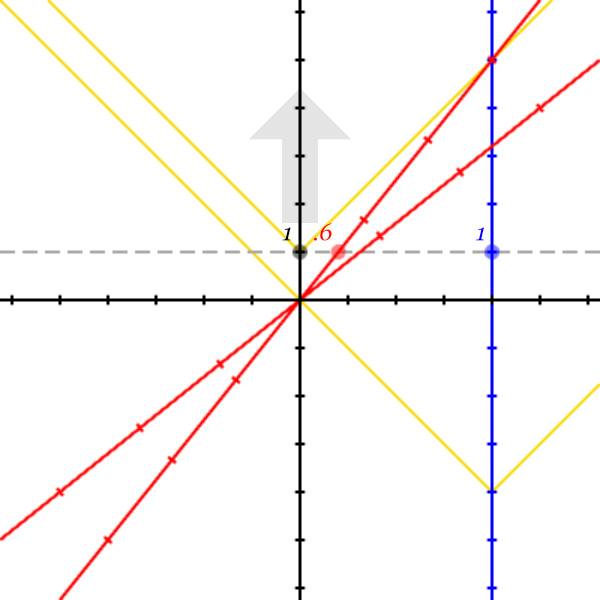

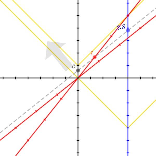

Variation 2
Start with the original script and animate the positions of the three observers along bob’s line of simultaneity. Display each observer’s clock where the simultaneity line intersects the observer.
# Add these lines at the top
let animation t = 0 to 5 step .01;
animation reps: 1;
# Add these lines before the axes commands
let simul = [line axis x bob offset t];
let bobLoc = intersect(simul, bob);
let tedLoc = intersect(simul, ted);
let aliceLoc = intersect(simul, alice);
# Add these lines at the end
event location: bobLoc, label: tauFromT(t, bob), bobStyle;
event location: tedLoc, label: tauFromT(t, ted), tedStyle;
event location: aliceLoc, label: tauFromT(t, alice), aliceStyle;
line line: simul, color: #AAA, dashed: true;

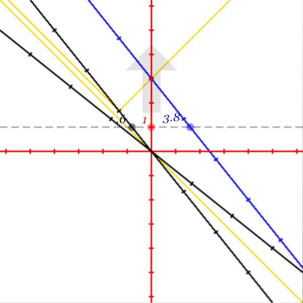

Variation 3
Start with variation 2 but now using Alice’s line of simultaneity. The diagram is still from Bob’s viewpoint.
# Change the animation assignment to
let animation t = 0 to 3 step .01;
# Change the simul variable to
let simul = [line axis x alice offset t];

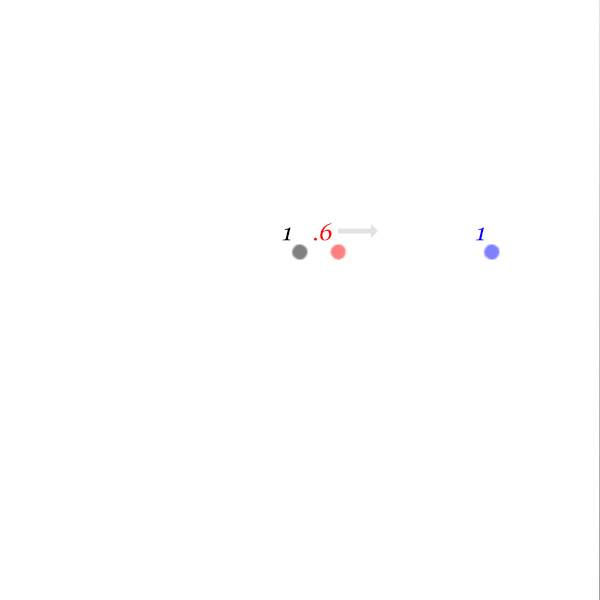

Start with variation 2. We will just show the events and use the animation’s time represent the time axis—each frame of the animation will be one-dimensional view. We will see Alice’s dot move from a steady dot representing Bob to a steady dot representing Ted. Each observer’s clock time is displayed by each dot.
# Add this line anywhere after t is defined.
diagram frame: [observer origin (0, -t)];
# Remove the axes and line statements

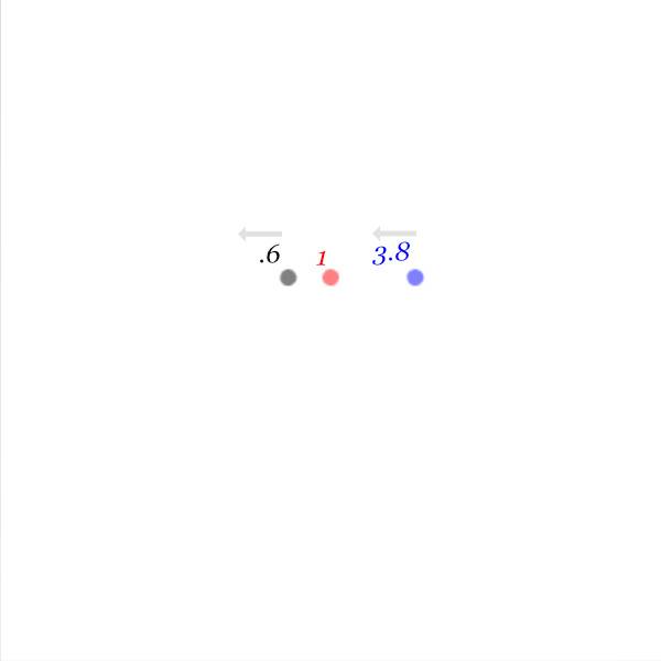

Variation 6
Start with variation 2. Again, we will just show the events and use the animation’s time to represent the time axis, but from Alice’s viewpoint this time. We will see Bob’s dot move away from Alice’s dot (which won’t move). We will also see Ted’s dot move toward and reach Alice’s dot. Each observer’s clock time is displayed by each dot.
# Add these lines anywhere
let alicePos = (0, t < alice);
diagram frame: [observer origin alicePos, velocity 0.8];

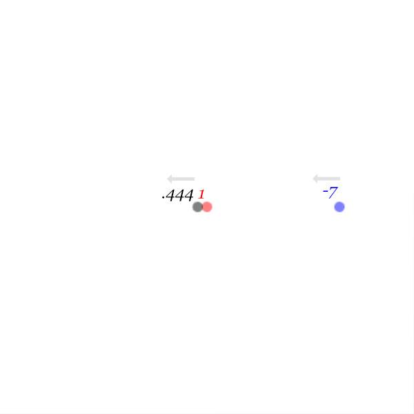

Variation 7
Start with variation 1, but let’s display Bob and Ted in the positions that Alice would see them. Also , display the clock times Alice would see. Note that I had to zoom out to get Ted's event dot in the attached diagram, so the scale is different from all the other diagrams.
# Remove everything after the “let alice = ...” statement
# Add these lines
let aliceLoc = (0, t, <alice);
let lightLine = [line angle +45 point aliceLoc];
let bobLoc = intersect(lightLine, bob);
let lightLine = [line angle -45 point aliceLoc];
let tedLoc = intersect(lightLine, ted);
event location: aliceLoc, label: t, aliceStyle;
event location: (tedLoc.x, t), label: tedLoc.t, tedStyle;
event location: (bobLoc.x, t), label: bobLoc.t, bobStyle;

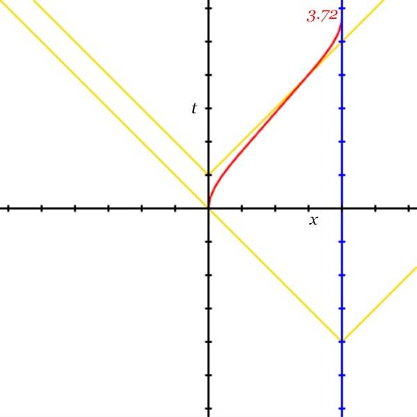

Variation 8
Start with the original script.
Alice now starts he journey in the same rest frame as Bob and Ted. She accelerates at 1g until she is one light year from Bob (as measured by Bob). She coasts until she is one light year from Ted (as measured by Bob). She then decelerates at 1g until she reaches Ted, where her acceleration ends. She should now be in Bob’s and Ted’s rest frames again.
Display Alice’s ending clock time at her ending position.
# Replace the assignment to Alice’s observer variable to this
let alice = [observer acceleration 1 d 1, velocity d 3, acceleration 1 d 1];
# Remove Alice’s axes
# Add this at the end
let aliceTau = tauFromD(5, &alice);
worldline observer: alice, clip: (0, 0), (4, inf), aliceStyle;
label location: (4, aliceTau), text: aliceTau;

Whoops! I forgot about grids! Yes, you can also draw grids for any inertial frame. As the relative speed of the moving frame increases, grids can get crazy dense, so the tool will automatically decrease the density of the grid lines as needed.
Interactivity would be a nice feature.
Hyperbolic graph paper is somewhat useful, analogous to polar graph paper.
(Here are some from Tom Moore's website.)
http://www.physics.pomona.edu/sixideas/resources.html
A single hyperbola is good to show how events are mapped under a boost.
A single hyperbola (the Minkowskian circle) also defines "perpendicular" as the tangent-to-a-circle.
Hyperbolas also describe uniformly accelerated astronauts.
Of course, I will also suggest "clock diamonds" and "causal diamonds" drawn on "rotated graph paper".
See my Insights for details.
See also my AAPT presentation (where I argue that "rotated graph paper" is the best kind of graph paper for special relativity): https://www.aapt.org/docdirectory/m...dGraphPaper-CalculatingWithCausalDiamonds.pdf
Here's how I have used them: (image search)
https://www.google.com/search?q=relativity+on+rotated+graph+paper&tbm=isch
https://www.google.com/search?q=relativity+on+rotated+graph+paper+site:stackexchange.com&tbm=isch
https://www.google.com/search?q=relativity+on+"rotated+graph+paper"+site:physicsforums.com&tbm=isch
In addition to [itex]\beta[/itex] and [itex]\gamma[/itex],
I think there should be support for [itex]k[/itex] (the Doppler factor, the Bondi k-factor), rapidities, and light-cone coordinates.

Here's something I work on from time to time.
https://www.desmos.com/calculator/emqe6uyzha ( robphy's spacetime diagrammer for relativity v.8e-2021 (time upward) )
https://www.desmos.com/calculator/led14lihz2 ( robphy spacetime diagrammer for relativity (v9g) )
https://www.geogebra.org/m/HYD7hB9v (old version: Relativity on Rotated Graph Paper (robphy) - MAA2016) - https://www.geogebra.org/m/HYD7hB9v#material/VrQgQq9R
Use this tool to draw a segment between two points.
Click back on the arrow/cursor... then you can drag the points of the segment.
That's a "spacetime ruler". (Inkscape? for spacetime diagrams.)

Desmos has some advantages like interactivity.
But it's hard to maintain. Every update, it seems, generates a new URL.
So, it's good for keeping versions [if you keep track of them], but hard to "update" and share it automatically with others.
On the other hand, using Glowscript or Python on http://trinket.io, there is a fixed URL for a program, which one may continually update.
Freixas said:
The spacetime ruler, if I understand from using it, basically acts as a measuring device. If the angle of the segment is less than 45, it's a space ruler and if greater, it is a time ruler. The angle of the line implies a particular inertial frame. Because I haven't had time to go through all your materials, I'm not sure what the boxes tell you. For instance, if you just had tick marks, would we lose any information?
The diamonds are the ticks of a "standard-issue" light clock along the timelike diagonal.
The area of a diamond is Lorentz-invariant.
The diamonds define the tickmarks... operationally, essentially via a radar method.
Pedagogically, they are not "calculated" because that's what some formula says it should be.
Instead, the ticking light clock determines the tickmarks (for time and space) for that inertial observer's frame of reference. They determine the "spacetime grid" for that observer.
The diagonals of the diamond yield the time and space axes for that observer
(they encode perpendicularity and are a proxy for a hyperbola).
The edges of the diamond yield the light-cone coordinates for that observer.
Freixas said:
I can see how this could be useful. I was planning on displaying the coordinates under the cursor, but a ruler could be handy. I'll have to think about this, because I might want a ruler capable of measuring both time and space relative to a given inertial frame.
One light-clock diamond is the prototypical unit of displacement in spacetime and
can be used to tile the plane to lay out the "spacetime grid" for an observer.
Hence, the "rotated graph paper" as the grid for the observer at rest in the diagram,
and also as a graphical aid to more easily [by construction and counting] draw the grid for another observer.
