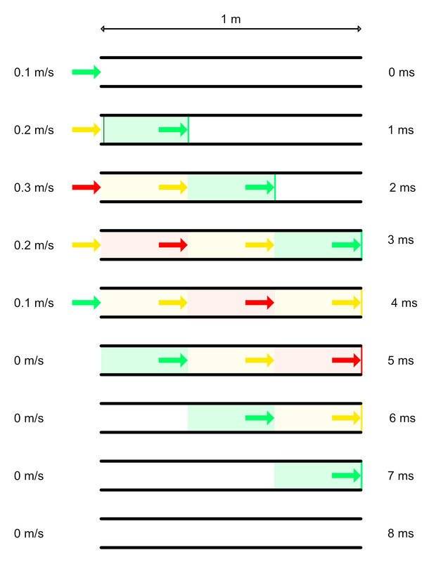

Here's a picture of what happens based on observations:
We have a stream of air flowing in. Let's assume we can increase the air flow in steps of 0.1 m/s. The diagram shows what happens as the air flow increases to 0.3 m/s and then drops back to 0.
After 1 ms, everything in the green box is moving at 0.1 m/s. The thin black vertical line near the opening is suggestive of how far the air the flowed into the tube has moved—it's not to scale. The pressure wave is traveling at the speed of sound, however, and has covered about 1/3 of a meter. The air behind the pressure wave is all traveling at 0.1 m/s.
In 3 ms (roughly), air flows out of the tube at 0.1 m/s. It continues to do this for 1 ms, after which it jumps to 0.2 m/s, etc.
If I try to picture this at the molecular level, I picture billiard balls. As I described in my OP, I can't see any way to make the pressure wave travel faster than the speed of the air coming in. Even if I could, I have to explain why the molecules behind the pressure wave are accelerated to 0.1 m/s, then 0.2 m/s, etc. Explanations for sound waves usually have the pressure wave moving at the speed of sound, but the particles just "vibrate" in place.
Since everything really happens as general trends in the somewhat random interaction of trillions of molecules, it seems it should be possible to explain what's going on at that level. I thought this would be a simple question, but I've asked it elsewhere as well to a deafening silence.

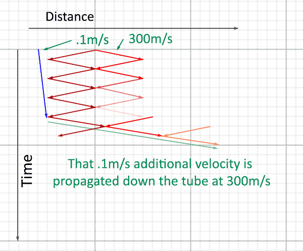

The collisions all take place at the speed of sound. The wave travels at that speed. But the drift velocity of the net motion mimics the drift velocity of the incident wind. (0.1 m/s)
Freixas said:
From a molecular point of view, why does the pressure wave travel much faster than the average speed of the molecules that caused it?
Because that molecule is actually moving at >= 300m/s. If it gets a bump of .1ms, now it can travel at 300.1m/s to reach the next molecule - way faster than .1m/s. It's only adding .1m/s to the already existing 300m/s. And that is the speed at which one molecule can transmit its kinetic energy to the next.
Freixas said:
Again, from a molecular point of view, why the do molecules trailing the pressure wave get accelerated up to (in the first step) 0.1 m/s?
They don't. They get accelerated from 300m/s to 300.1m/s.Think about a bar of steel. If a wave could only be transmitted as fast as the input, then moving one end up at .1m/s would mean that wave could only propagate the length of the bar at .1m/s.
In fact, we know that atoms in a bar of steel can transmit their energy at the speed of sound in steel.
You move the bar, and that signal is propagated at 6000m/s.
In air, it's similar. The air can transmit a signal at >= 300m/s (i.e. the speed of sound in air).

so all the rightward moving particles are at 343.1. At the wavefront, we can expand the picture to look like this:
+343.1 → ← -343 +343.1 → ← -343 +343.1 → ← -343 +343.1 → ← -343 +343.1 →​
Hmm... The average speed is 0.1 m/s. The average velocity is 343.05 m/s, but the wavefront is at 343.1 m/s. You can't have the wavefront influenced by the average speed or else you get all sorts of artifacts.
(DaveC426913, your drawing arrived while I was typing all this. It helped me find the problem in the above diagram)
Ok, the error is that I have particles colliding in synch even though they are moving at different speeds. Using DaveC426913's diagram, it is much clearer that the wavefront advances at +343 m/s (or whatever the average speed is) and the particles left behind move at an average speed of 0.1.
The other thing is Wikipedia's claim that this depends on temperature and composition. I seem to have only taken temperature into account. I'm assuming composition includes fluid density. If we pack the particles closer or further in my little model, it makes no difference (a change in temperature, however, seems to have a direct influence).
This is quite a step up from where I was when I started!

DaveC426913 said:
Sorry, I'm back. I was thinking of how to explain this to someone else (always a good test) and things aren't working out.
The diagram above mixes average relative velocities (.1 m/s) with absolute speeds (300 m/s). So the blue line, if we were to remain consistent, would be a particle traveling at 300.1 m/s. We can still follow the diagram from this point, though.
The diagram states that the .1m/s is propagated at 300 m/s. Given what I learned about elastic collisions, the particle hit by the incoming 300.1 m/s particle will now move right at 300.1 m/s. Every 300 m/s particle it hits from then on will move at 300.1 m/s. So the wave front is propagated down the tube at 300.1 m/s.
To infer this, I don't need to calculate exactly when each collision occurs. I just need to track the leading particle, which is always going to move at 300.1 m/s. It's not the same particle all along the way, but that doesn't matter.
This doesn't sound right. Now 0.1 m/s is not much speed, but it could be 50 m/s and now we're getting wavefronts traveling at significantly different speeds.
Am I wrong? Did I miss something?
It's an average.
You do not have a leading particle always advancing at exactly 300.1 m/s all the time. You have a collection of particles moving in random directions at significantly more than 300 m/s. It is the peak of the density distribution that advances at 300.1 m/s.
In my [very strongly held] opinion, trying to understand this at the molecular level is the wrong thing to do. You know that it will work out because ideal gas behavior follows from molecular behavior and pressure waves follow from ideal gas behavior. Trying to jump directly from one abstraction layer to another two hops away is not optimal.
