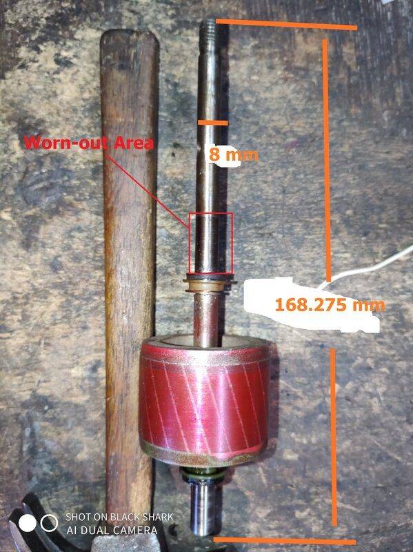

I have a motor, whose shaft is worn-out. Please comment on my repair method.
Hello everyone,
I have a fan's induction motor, whose shaft is worn-out. I would like to use Shielded Metal Arc Welding (a.k.a. Stick Welding) to fill some metal into the worn-out area. Then, I will do machining to cut the excessive metal out. However, somebody told me that if the temperature of the shaft is too hot, it will deform and not be able to fit in my fan. I then Google about the forging temperature of a Carbon steel - 0.50% carbon content. Wiki said it is 1230 celsius. I should not go over 70% of 1230 celsius, which is 861. So, I would like to use some substance as an indicator that smokes at 861 celsius. Could you please suggest the substance that is cheap, available on marketplace, and easy to use?

Could you post a picture of the damaged shaft?

I'm sorry for the late reply. Here are more details about my questions
Here is the picture with dimensions and the worn-out area marked.
The Fez said:
SMAW, or any other traditional welding technique will not work, because you are depositing molten metal in a localized area, which will cause distortion in the Heat Affected Zone... However, there are many shops that can perform a spray metal deposition, which slowly deposits metal on the shaft while it rotates.
First, if I use a current limitable inverter welder and do SMAW at the worn-out area in the picture at the lowest current limit (20A). How severe would the heat affect the rest of the shaft? Second, I have heard about the cold forging cream named Belzona for fixing this issue. However, the price is expensive. If there is no other way, then I have to buy it.

Thank you for these good questions.
1. I will press the shaft out of the armature.
2. This is a domestic fan.
3. No, the fan does not loose. The worn-out area on the shaft was inserted into a bush.
4. Just a pin. Not keyway nor spline. See the second picture below
5. Shaft bearings are bushes.
6. I will check this out.

Thank you. Please see the pictures below
  • Armature shaft of a small motor lying on a workbench beside a wooden handle, with a red-wound armature core; orange annotations mark an 8 mm diameter section, a 168.275 mm length and a red box labelled Worn-out Area.
  • Slide titled Mechanical Drive Assemblies showing four shaft-to-hub connections: set screw, pin (circled in red), keyway and spline shaft, with a list of their torque ratings.
So let me guess. That worn part of the shaft goes into a brass bushing. And the fan squeals when it is run correct? Do you know how much the shaft is worn? Chances are not much and if my above assumptions are correct, you need to replace the bushing, that's it. It is likely an oil impregnated bushing and in my experience when they squeal, the only option is to replace. If there is a little play between the new bushing and worn part of the shaft it will likely run quiet.

That is an easy problem to solve, once you know how.
I have used stainless steel sleeves to repair worn shafts on several occasions. There are sleeves available to fix shaft wear caused by lip seals that may work for your application. You may also be able to buy a stock shim sleeve to fit that shaft. Some hobby shops sell thin wall tube in various materials and sizes.
Google 'Shaft Repair Sleeve'
If the shaft wear is significant you can fill the cavity with a metal loaded epoxy as you press the sleeve into place.
A steel shaft wears when particles of hard grit becomes embedded in the softer bush material, so you will need to replace the bush, clean, and lubricate the bearing surfaces. The bush may need to be made slightly over-size to fit a repair sleeve.
