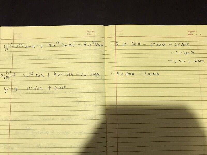

I was trying to solve
y^{(5)} + 2 y^{‘’’} + y’=0$$
The characteristic equation:
m^5 +2m^3 +m =0$$
Gives three particular solutions:
##y_1 = 1, ~ y_2= \cos x , ~ y_3= \sin x##
I assumed ##y_4 = u(x) \cos x##, but replacing this ##y_4## didn’t give me ##u##.
Here is what I’m getting:
So, first of all, when your differential equation does not contain the function itself, but only derivatives, it is usually simpler to rewrite it in terms of a differential equation for the lowest derivative. In this case, the lowest derivative is ##y'## and therefore the easiest thing is to set ##f = y'## and obtain
f^{(4)} + 2 f'' + f = 0.
The characteristic polynomial has two double roots ##\pm i##. It will generally be easier to work with the complex exponentials ##e^{\pm ix}## than with the cos and sin functions. Doing so you should not have any problems identifying the solutions.
Note that setting ##f(x) = u(x) e^{ix}## should still give you the general solution, not just one extra solution, just as in the previous problem we could identify all solutions from ##u^{(3)} = 0##.

@Orodruin after putting ##f = u e^{ix}## I’m getting
u^{(4)} + 4i u^{(3)} -4 u’’=0
Right. So this is a fourth order equation where the lowest derivative is a second derivative. Any first order polynomial will therefore be a solution. You can go on and try to find the remaining solutions but they will correspond to the other roots of the characteristic polynomial.
To be specific, if you let ##h = u''## then ##h'' + 4i h' - 4h = 0## has the characteristic polynomial ##m^2 + 4im - 4 = (m+2i)^2## and therefore has the solution ##h(x) = (Ax+B) e^{-2ix}## so ##f(x) = (ax+b)e^{-ix} + (cx+d)e^{ix}##.
However, you do not need to do this to find the remaining solutions as you can already find them from the same type of argumentation for the other roots of the original differential equation.
