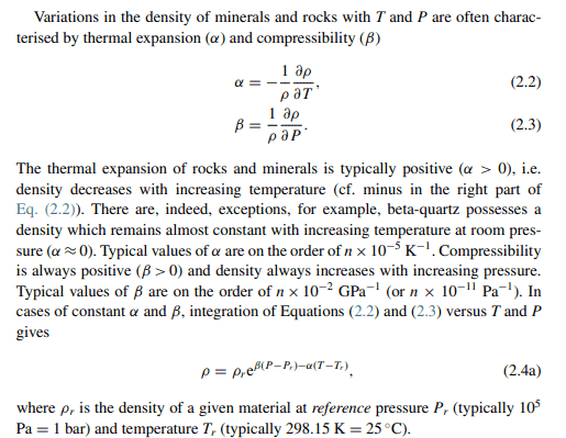

Can someone please help me go from equation 2.2 and 2.3 to 2.4a (see image)?
α = − (1/ρ)(∂ρ/∂T) (2.2)
β = (1/ρ)(∂ρ/∂P) (2.3)
ρ = ρr.e^β(P−Pr)−α(T −Tr) (2.4a)
See image

How Beta and Alpha show together in the exponencial? I can solve for only one coefficient (alpha or beta), but not for both. What steps am I missing? Thanks in advance.
Hi. Assuming ##\alpha## and ##\beta## are constant,
d\rho=(\frac{\partial \rho}{\partial T})_p dp +(\frac{\partial \rho}{\partial p})_T dp=-\rho \alpha dT + \rho\beta dp
\frac{d\rho}{\rho}=- \alpha dT + \beta dp
ln\ \rho - ln\ \rho_r = - \alpha (T-T_r) + \beta( p-p_r)

Each partial differential equation shows how ρ changes as one of P and T varies but the other stays constant.
You can treat one as an ODE and solve it in isolation, e.g. ##\rho=Ae^{-\alpha T}##, but still bearing in mind that this is with the other constant. So A here is a function of the other independent variable, β. Correction: I mean P.
Likewise, ##\rho=Be^{-\beta P}##, where B is a function of T.
Can you work it out from there?

Thank you so much! But can you show one step before your first step? Like, how did you assumed that dρ=(∂ρ/∂T)pdp+(∂ρ/∂p)Tdp

That should be
d\rho=(\frac{\partial \rho}{\partial T})_p dT +(\frac{\partial \rho}{\partial p})_T dp

Hi again, actually, I'm still stuck. Can you show more steps after the ρ=Ae^−αT, please? I mean, what would you do next. Thank you, in advance!
First, see my correction to post #4.
One way would be to differentiate ##\rho=A(P)e^{-\alpha T}## partially wrt P and substitute for ##\frac{\partial \rho}{\partial P}## from your original equations.
Try to get an equation involving only β, A and A'.
