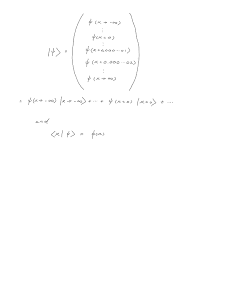

By the Principle of Superposition, a state vector can be defined as pic.01

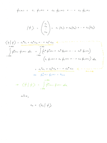

also, the state vector can represent a wave function in a continuous case as pic.02

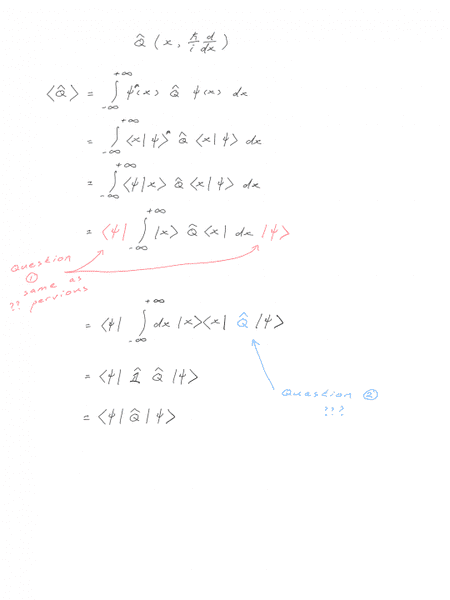

My (1) question is, in pic.03, why the state vector can be pulled out from the integral?
I have an idea but I think it should be wrong:
As shown in pic.02, the state vector is a set of values that each element is the value of the wave function, e.g. phi(0), phi(0.002), etc.
Thus, it can be considered as a constant since every elements will never change
Therefore, it can be pulled out from the integral

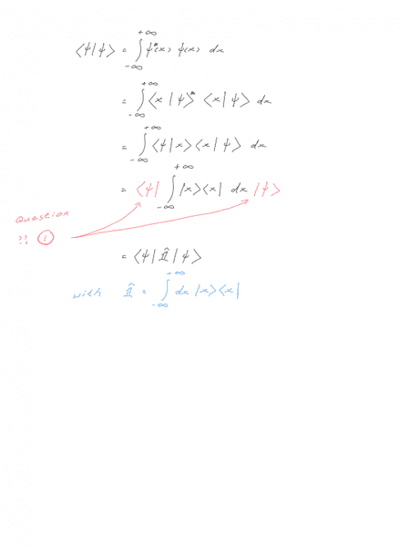

Considering, in pic.04, question (2), Q is an operator which contain a momentum component, a differential operator. If the state vector is constant, it should give zero value when a momentum operator act on it and the Dirac representation will be failed.
So, if it is not a constant, how can it be pulled out from the integral?
And my (2) question is that, in pic.04,
step 4 to step 5,
why the operator Q can skip the bra(x) vector and act on the state vector??
For a continuous basis such as ##| x \rangle##, it doesn't make sense to express it as a column vector.
##| \psi \rangle## is a state vector, corresponding to a ray in Hilbert space. In a sense, it is an abstract construct that has no particular dependence on ##x## or any other variable (except maybe time), so you can take it in and out of the integral as you wish.
Saying that ##\hat{P}## is a differential operator is incorrect. Only in position representation is it a differential operator, i.e., when you have already projected the state onto the position basis ##\langle x | \psi \rangle##. You could as well express the state vector as
| \psi \rangle = \sum_i c_i | p_i \rangle
with ##\hat{P} | p_i \rangle = p_i | p_i \rangle##. In the momentum basis, ##\hat{P}## is definitely not a differential operator.
In summary, you have to be careful to distinguish ##| \psi \rangle## from its various representations.
The correct transition between the position representation and the braket notation in the first line of the integral is actually
Q_x\langle x|\psi\rangle = \langle x|\hat{Q}|\psi\rangle
where ##Q_x## is the operator ##\hat{Q}## in position representation.

Your question is why is the following valid - ∫<x|u><u|y> du = <x|∫|u><u|du |y>
The rigerous answer lies in an advanced area of mathematics called Rigged Hilbert Spaces:
http://artssciences.lamar.edu/_files/documents/physics/webdis.pdf
It is NOT recommended for the beginner.
Non rigorously its justified by sloppy use of limits
∫<x|u><u|y> du = limit Δu → 0 Σ <x|ui><ui|y> Δu = limit Δu → 0 <x|Σui><ui| Δu |y> = <x|limit Δu → 0Σ|ui><ui Δu |y> = <x|∫|u><u|du |y>
Justifying and giving meaning to each of those steps is what's hard.

Your pics are a bit hard to read. It doesn't hurt to learn LaTeX in posting here!
I answer the question concerning pic 1. Your confusion is due to mixing notations in a quite confusing way. You have to distinguish between abstract vectors, which you write in the Dirac bra-ket notation like ##|\psi \rangle##, and components with respect to a complete orthonormal basis. The mapping is one-to-one, i.e., you can use the completeness relation of the basis,
