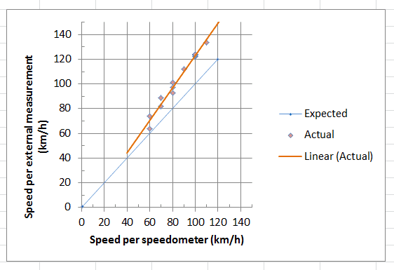

I am checking the accuracy of my speedometer.
When my speedo says I'm doing 100km/h, I record an actual speed of 123km/h.
When my speedo says I'm doing 60km/h, I record an actual speed of 68km/h.
I have more data but it corroborates this simple example: error increases with increasing speed.
I will make a chart, but for now...
What is the appropriate way to represent an error like 100 vs. 123?
Do I want to represent it as a fraction of my speedo? (23/100 = 23% error)
Or as a fraction of my actual? (23/123 = 18.7% error)

IMO, the latter. The displayed speed is about 18.7% under the true speed of 123 kph, and is about 11.8% under at a true speed of 68 kph.
I think your speedometer is going bad -- those displayed speeds are pretty far off. Car manufacturers typically produce speedometers that are within about 5% of the true speed, with a bias toward displaying a higher speed than the actual speed. I think I read that somewhere.

DaveC426913 said:
I have been having problems with my leaky tires lately. Are you suggesting a wrongly-inflated tire could have this much of an impact?
Not unless the tire was way over-inflated. Larger tires travel farther for a given number of engine revolutions, leading to a greater true speed than indicated by the speedo.
I don't know what kind of speedometer you have, but some mechanical speedos have a rotating cable that is driven from the transmission. At the speedo end of the cable is a magnet that causes another magnet to swing through and arc. The faster the cable turns, the greater the arc the speedo needle moves through. If the speedo is electronic, it could be that there is a sensor that isn't working correctly.
I'm not an expert on speedometers -- just passing on what little I know about them.

Theory says: There are magnets placed on the axle, rotating under a sensor, which picks ups the pulses of a magnetic field, each time the wheel rotates.
The speedometer uses the time between the pulses and the traveled distance of one rotation of the tires to calculate the speed.
My understanding to find the error, use the two velocities and it will be the aboslute value of the difference between the predicted velocity and actual velocity divided by the actual velocity.
Error is aprox: .18669
0.18 or 18%

Guapa, I have no idea what you're trying to say. If you suspect something about what I know, why don't you just ask me?
I don't understand what Montana has to do with anything - especially here, where metric is the norm - but you've still come to the wrong conclusion.
If I were in Montana seeing 80mph on my speedo (and if the error keeps increasing at the same rate, it would be in excess of 30%) I would, in reality, being doing something in excess of 97mph.
Finally, please stay on-topic (my topic).
Here is my first round of data.
Not a lot of data but, with cruise control, I get pretty accurate readings.
And here is the second round of data. This one has a wider margin of error because my cruise control stopped working, so I had to keep it steady manually.
The 100/123 data ponit is actually six data points super-imposed.
