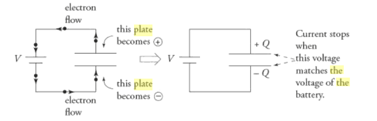

When it comes to charging a capacitor I'm under the impression that when a parallel plate capacitor is hooked up to a battery, that electrons simply flow from the negative terminal to the plate that is connected to the negative terminal, causing that plate to become the "negative plate" and electrons that are on the plate connected to the positive terminal will flow towards the positive terminal making that plate the "positive plate". This process occurs until the voltage of the capacitor matches the voltage of the battery. This is basically what the diagram that I attached is trying to explain.
I have two questions with respect to this explanation:
1. When I was reading up on charging a capacitor, I read that work is required to transfer charge from the positive plate to the negative plate and that transfer of electrons from one plate to another is what charges the battery, clearly not what I explained above in the first paragraph. I am obviously missing something here. I would appreciate your help in clarifying the process of charging a capacitor.
2. There is a space between the first plate and the second plate, which means the circuit is incomplete UNLESS what is happening is that electrons are being transferred from the "negative plate" to the "positive plate". Is that true?

Actually I think when my book said that the electrons were being transferred from the positive plate to the negative plate they meant indirectly by traveling all the way around the voltage source rather than simply crossing the capacitor (b/c I now realize that that is unlikely due to the presence of the dielectric)
That is also misleading, if it gives you the wrong idea that the electrons move at high speed all the way round the circuit. For typical components that you would find in battery powered electronic circuits, each individual electron will only move a fraction of a millimeter when you charge the capacitor. You are not moving electrons all the way from one plate to the other. You are just pushing the electrons on one plate slightly closer together, and pulling the electrons on the other plate slightly further apart, compared with the positive charges which can't move around because they are part of the nuclei of the atoms in the plates.
Consider parallel plates separated by a vacuum. Because the plates are in such close proximity, if an electron is added to one plate its electric field line "reaches across" the gap and repels exactly one electron off the other plate. So to an outside observer, it may appear that the electron has jumped the gap, but nothing could be further from the truth. Only field lines span the gap, electrons themselves don't jump across.
The presence of a material in the gap changes things somewhat, having the effect of magnifying the capacitance by its material constant ##\epsilon##r.
