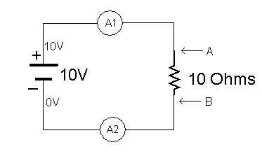

I have posted a pic of my question.
Suppose there are two ammeters A1 and A2 placed in a circuit as shown in the diagram. I want to know if the reading of A1 is same as that of A2. Books say that it is. But my logic is that since current crosses a resistor it gets lowered. Hence A1 > A2. Please explain me what is true and why.

Think of it this way - can charge go anywhere else other than around that one loop?
The current is the same anywhere in that loop, and is a total function of total circuit impedance, and source voltage.
The voltage is what gets dropped across the resistor, not the current, but the amount of voltage that is dropped, does depend on current. Voltage is a measure of electrical potential energy, and is measured in Joules/Coloumb.
Kirchoff's Voltage Law is a physical law that states that the sum of voltage drops around your loop equates to your source voltage.
Ohm's law gives a mathematical relationship of voltage to current and impedance.
V = IR where V is voltage measured in volts, I is current measured in amperes, and R is resistance measured in ohms.
The source voltage divided by the resistance, will yield the total circuit current, that for a series circuit, is the same value of amperes at any point.
Thinking of Current as a flow of charge around a circuit, if you move some charge into one part of a circuit then that excess charge will be pushed around to other parts of the circuit. To achieve just a small imbalance in charge (as across a capacitor, for instance) requires a lot of effort. If a steady current were flowing around the circuit and it didn't 'even out' around the loop, the whole thing would explode with attractive and repulsive forces involved as more and more charge built up in one place.
Current In = Current Out is the rule.
What DOES get less as you go round a circuit is the Potential difference - as energy is dissipated in the various loads (resistance etc.).

In a series circuit like that one, the current is not dropped by the resistor, instead it is limited by the resistor, is the same no matter where it is measured
Its the Voltage that drops across the resistor
lets look at your circuit with some values added
Using Ohms Law, what do you think the current flowing in the circuit is ?
hint... I = V/R
That will be what is measured by each Ammeter
now look at the resistor, what is the voltage at point arrowed A, and what about the point arrowed B ? and why ?
Now that you have worked out the current flowing in the circuit, use Ohms Law again and work out the Voltage drop across the resistor hint ... V = I x R
hint... I = V/R
Dave

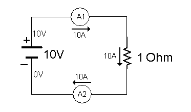

Dave, I understand you. I am sorry I had not used any calculation in that question. I am back with the question even clearer. I have attached the pic.
In the circuit I have drawn, 10 amps of current flows. Voltage is 10 V and resistance of R1 is 1Ω. This time I have used calculations. My question is the same. What happens to the current when it flows through the resistor. From my knowledge I know that the current flowing through point 'A' in the diagram at any instant is 1 Coulombs. Then how much current flows through the resistor ? Is it 1 Coulomb. If it is then why ?
I am sorry to interrogate, but the unit of current is Ampere, and coulomb is unit of charge. As per ohms law, 10A Current will flow, to balance the equation.
you didnt attach the pic :)
anyway 1 Coulomb = 1Amp of current past a given point in 1 sec
but there's no need to bring coulombs into these discussions it will only confuse thing more. just keep it to Amps, Volts and Resistance
OK as per your description...
If the voltage is 10V and the resistance is 1 Ohm then the current flowing around the circuit is 10 Amps
I = V / R = 10V / 1 Ohm = 10 A the resistor is going to get VERY hot!

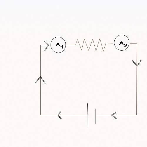

I have attached a pic.
I have assumed that 10 amps of current is flowing through the circuit. What happens to them when they reach the resistor ? 'A' stands for ammeter.

A lamp is a little like a resistor, yes it has resistance but that changes between its cold and hot condition, also resistors normally don't emit light, unless they are getting that hot that they start to glow red just before they fail.
Basically... In a lamp when energy (an electric current) is put into the tungsten filament, that additional energy causes some of the electrons of the tungsten atoms to move to a higher energy level. When those electrons drop down to their normal level, they loose energy, some of that energy is released as photons (light) some of it as heat.
You can't assume that there is 10 amps flowing as you have given no other info to substantiate that.
You need to tell us what the battery voltage is and you need to tell us what the resistor value is THEN you can work out what the current flowing is. THEN you can work out what else might be going on in the circuit ... for example how may Watts of energy is being converted to heat in the resistor etc
Reread my posts #5 and #7 :) they obviously haven't quite been understood yet ;)
