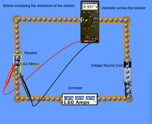

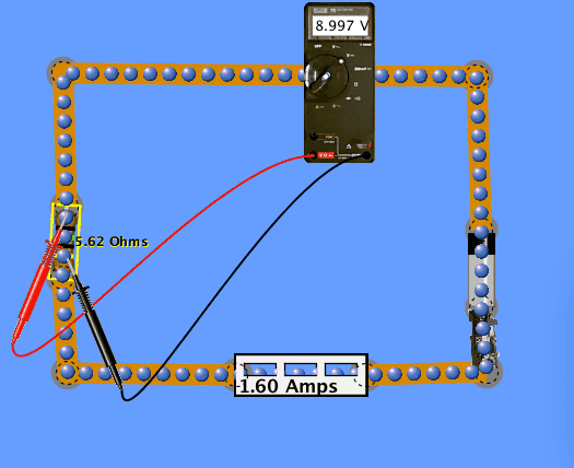

Slightly, I came across a question where the source is voltage but as the resistance increase, the voltage across the component also increases, I used some sort of animation ( virtual circuit) , it proves that the voltage is proportional to resistance but the current decreases. I have attached to two screenshot for a better understanding of my question. I don't understand the proportionality. I thought one element need to remain constant for proportionality to work, but in this case all the three elements varies.
I'm not understanding the figures. Where is the voltage source? Is the current measured at the bottom done with an ammeter? Or is that a current source of some kind at the bottom? Could you post a more traditional schematic of what you are simulating?

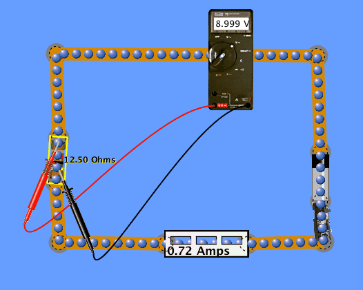

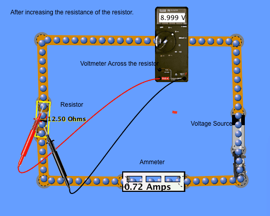

I have attached the screenshots again with some annotation. Thanks.
The pictures that you posted show 9 V across the component in both cases. I am not sure what you mean by "the voltage across the component also increases". The variation in the least significant digit appears to be just rounding.
In the screenshot, it shows two different voltages ( 4 S.F) before increasing- 8.997 After increasing- 8.999
And if I further decrease the resistance, it will show 8.991
In general, there is some internal resistance inside a realistic voltage source. You can model this as a ideal voltage source in series with a small resistor. So, you have a voltage divider between your external resistor and a small resistor in the battery.
Also, you have a large but finite resistance in a real voltmeter, and a small resistance in a real ammeter. I don't know if any of these effects are modeled in your simulation, but it can explain your results.
That appears to be just rounding error in the least significant digit for whatever simulator you are using. Just ignore it.
To put this in perspective, you have changed the current and resistance by a factor of more than 2 and the voltage has changed by a couple parts in 10000. That is essentially constant.

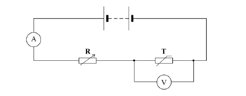

I have attached a ideal circuit where the internal resistance and resistance of the wire is negligible .
If I say the temperature of of the thermistor is constant, then why does the voltage across R increase when we increase the Resistance of R. I am still misunderstanding the concept.
(NOT A HOMEWORK QUESTION)
Thanks
What happens to the "total" resistance if you increase the value of R?
The total resistance will also increase as they are in series. so the current will decrease.
Yes.
But since the thermistor resistance is constant, what can you say about the voltage across it?
cnh1995 said:
Yes.
It will decrease
Kajan thana said:
It will decrease
Yes. So what can you say about the voltage across R?
Kajan thana said:
It will decrease
So the other one have to increase. Thank you. Make sense now.
Thanks
This circuit is totally different to your first one !
you should stick to one circuit at a time and learn to understand it, before making changes
you are measuring the voltage drop across that thermistor.
The voltage drop will vary as the thermistor changes temperature and therefore changes resistance
if kept constant temp, then the voltage across it won't change
If you vary the resistance of R, the voltage will change across the thermistor and R
how do you know it changes ( yes it does) but you are not measuring the voltage across R
IF you put your voltmeter across R and change the value of R, then yes the voltage will change according to Ohms Law
why, because the current through it will change
you could plot a graph of V for different values of R and I (current)
NOTE: If R was the only resistance in the circuit ( the thermistor or other resistance wasn't there)
Then the voltage drop across it wouldn't change !. Only the values of I and R would change as
the value of R was adjustedDave
