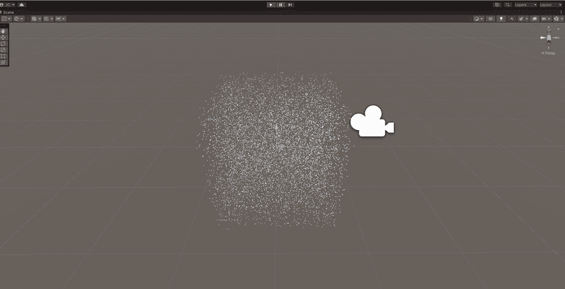

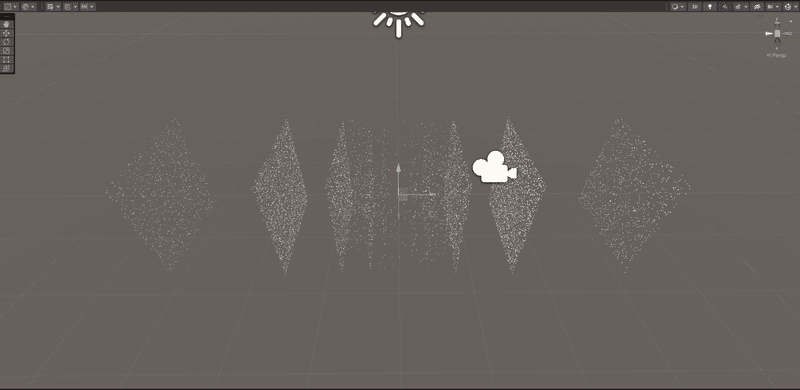

Now for something weirdly funny. I guess the GPU does things a bit differently from the CPU when it comes to precision. I ran into the issue that a population of electrons moving in a homogenous magnetic field will quickly sort themselves into 'sheets' or 'layers' at roughly powers of two ratios from each other in distance along the field lines, with a handful of outliers that don't fit into the ratio. See the images below:
First image is electrons in their initial positions. All electrons are within 1 unit (meter) of the origin along each axis. A homogenous magnetic field with a vector of [0,0,1] is applied, which points in the direction of the blue arrow here in the Unity editor. The electrons quickly move along the z-axis until they sort themselves into the layers shown in the bottom image. They don't stop moving completely, they still gyrate around the magnetic field lines as if they were moving along the z-axis, but they don't actually move along that axis any longer.
The layers have a z-value of positive and negative 4, 2, 1, 0.5, and 0.25, with a few in between once you get close to the origin.
I haven't really even begun to investigate this phenomenon, as I thought it was too funny and interesting to wait to share.

Well, after some experimenting it turns out it's not an issue with the GPU, as it happens when I use the CPU as well. I just hadn't let the simulation run long enough to notice the issue (because it takes MUCH longer for the simulation to advance far enough on the CPU than on the GPU) . I believe it comes about when multiplying the velocity of a particle by a very small time step value and then trying to add that result to to the particle's position while using single precision floating point numbers. Simply increasing the time time step improved the issue, but didn't fix it entirely. Unfortunately GPU's all use single precision floats, not doubles.
