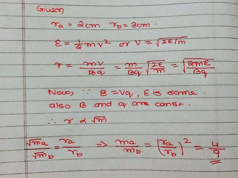

Two particles A and B having equal charges +6C, after being accelerated through the same potential difference enter a region of uniform magnetic field and describe circular path of radii 2 and 3cm repectively. The ratio of mass of A and B is ______
Force on the particle in a magnetic field = Bqv
In a circular path, mv^2/r = Bqv
→r = mv/Bq
I don't know if I should consider their velocities to be equal.
If the velocities are equal, the r(A)/r(B) = 2/3 which is incorrect.

Do you know how to relate the final speed of a particle to the potential difference through which it is accelerated?

E = Vq
→0.5mv^2=Vq
→v = √(2Vq/m)

OK. Good. Can you see how to use that?

The particles have different masses but have equal charge.So when it's accelerated through same potential difference, they will gain equal electric energy=Vq=kinetic energy
Vq=.5m1v12=.5m2v22
∴m1/m2=(v2/v1)2
Similarly when entering in Magnetic field due to different velocities they will follow different circular path of radii ra,rb respectively.
m1v1/ra=m2v2/rb=qB
I think I got it. Thank You :)
