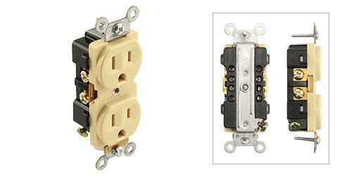

another approach is an inrush limiting thermistor.
http://www.ametherm.com/
tutorial here
http://www.ametherm.com/inrush-current/inrush-current-faq.htmlIf it works you could put it in an outlet box on end of an extension cord, in series with one half of a receptacle.
to separate the two halves break off the little metal tab on hot side(hot has shorter slot & brass colored screws),
and replace with one of these:
http://www.ametherm.com/inrush-current/as-series-inrush-current-limiters.html
Be aware it'll run hot so give it plenty of clearance and leave the leads long. Use a double box.
Paint that half of receptacle same color as drill so you'll remember which one to use.
