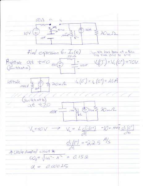

I need to find an expression for IL(t) i attached scans of what i have tried. I am not sure i did it right could you please take a look
see post # 2 for my attempt at solution

anybody
right so far, now plugin the equations of parallel rlc step response.
