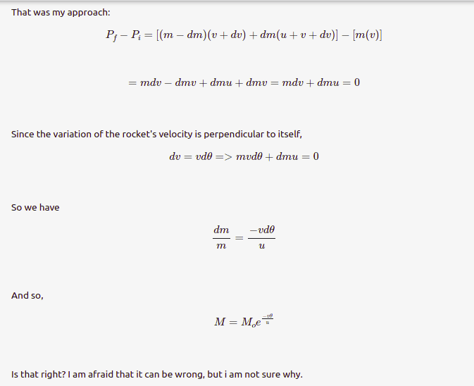

Find the relation between the mass of the rocket (initial mass = M_o) and the angle between the velocity and the initial velocity. The gas is ejected with velocity u with respect to the rocket in a direction perpendicular to rocket's velocity v.
That was my approach:
$$P_f - P_i = [(m-dm)(v + dv) + dm(u+v+dv)] - [m(v)]$$
$$= mdv - dmv + dmu + dmv = mdv + dmu = 0$$
Since the variation of the rocket's velocity is perpendicular to itself, $$ dv = v d \theta => m v d \theta + dm u = 0$$
So we have $$\frac{dm}{m} = \frac{-v d \theta}{u}$$
And so, $$M = M_o e^\frac{-v \theta}{u}$$
Is that right? I am afraid that it can be wrong, but i am not sure why.

Please fix the LaTeX. We cannot read the bottom line.
I am not sure where should i fix. In my pc everything is right:
Handwritten-style typeset derivation of rocket momentum: P_f - P_i = [(m - dm)(v + dv) + dm(u + v + dv)] - [m(v)], simplifying to mdv - dmv + dmu + dmv = mdv + dmu = 0; then dv = v dθ gives m v dθ + dm u = 0, so dm/m = -v dθ / u, and M = M_0 e^(-vθ/u).

You could motivate your treatment in a better way. For example, don’t use ##dv## because the change in the speed ##v## is zero so ##dv=0## by construction. Instead, use reasoning to say that you are taking the component of ##d\vec v## perpendicular to ##\vec v##.
Apart from that, it looks reasonable.

If this were the case, the exhaust would need to be perpendicular to the original direction of motion, not the current direction of motion (they are the same only at the beginning).

Thanks, I now understand my faulty reasoning.
