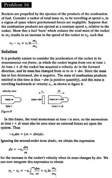

bentley4
66
Questions:
1. How can one tell that at time t+dt the velocity of the rocket is an infinitesimal quantity and the velocity of the ejected product a real quantity?
2. Why is for the mass of the rocket not simply written m-dm and why for the mass of the ejected product not written (+)dm?
The rocket starts from rest at time = t. If dt is small enough then the rocket has gained little velocity at time t + dt.
I'm not sure what you mean when you say,
"...the velocity of the ejected product a real quantity?"
You write,
"Why is for the mass of the rocket not simply written m-dm and why for the mass of the ejected product not written (+)dm?"
That would have made more sense to me as well, but it still works out.
Hi Spinnor,
In the solution, the velocity of the product is denoted with vr. So they are saying that the velocity is a real quantity (consists of a real number) as opposed to an infinitesimal quantity (like dv, a hyperreal number).
Ok, I think I understand this now.
