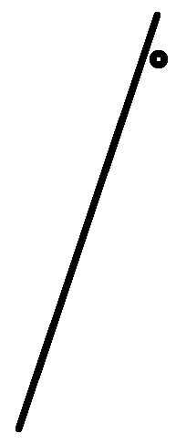

I do not agree that a peg needs to be modeled as a point. Similarly, a rod need not be modeled as a line. In three dimensions, both can be modeled as cylinders. In two dimensions, the rod can be modeled as a long thin slab and the peg as a circle.
Diagram of a thin black rod drawn as a straight line tilted diagonally from lower left to upper right, with a small circle representing a peg touching the rod near its upper end.
You ask about a force "normal" to a rod. That would be a force at right angles to the surface of the rod at the point of contact. If the peg is modeled as having a non-zero size, this will also be at right angles to the surface of the peg at the point of contact.
You also ask about a rope (wrapped around?) a peg. This time, the point of contact is spread around the peg. The "normal" force loses some of its meaning. Instead, we have the normal force over here, the normal force a bit further along and the normal force a bit further still. There are ways to calculate the net effect of all of those normal (and frictional) forces. It amounts to adding them all up using integrals, derivatives and a bit of trigonometry.
If the rope on peg is free of friction, the result is quite simple indeed. The assembly amounts to a pulley.
If the rope is tied to the peg, the result is again quite simple. The assembly amounts to a fixed attachment point.
If the rope on peg has friction, an exponential function results. [One solves a homogeneous linear first order differential equation. That is about the simplest sort of differential equation there is, so this example is sometimes used when teaching differential equations]. The maximum tension on the one side before the rope slips is given by a function along the lines of ##t_1 \leq t_2 e^{\mu\theta}## where ##\mu## is the coefficient of [static] friction and ##\theta## is the angle through which the rope wraps. It is easy to hold a rope taut against a huge counter-force if you can wrap it a couple of times around a tree first.
One can also think of the normal and frictional forces in relation to knots. A knot that holds is one in which tension from the load feeds back into tension in the knot sufficient to allow friction within the knot to resist the load. [If you wrap that rope a couple of times around the tree and then tuck your end under the first loop, you can walk away and not bother holding on]

In addition to what @jbriggs444 has said, can I add this.
Consider two objects (of any shape) with a single point of contact (P).
The objects’ surfaces have a common tangent at P. Their common normal at P is perpendicular to this common tangent.
Suppose one of the objects (say a rod, radius R) shrinks, keeping P fixed. The direction of the tangent (and hence the normal) at P are unchanged. This remains true as R→0 (when the rod is now a line, with a cross-section which is a point).
