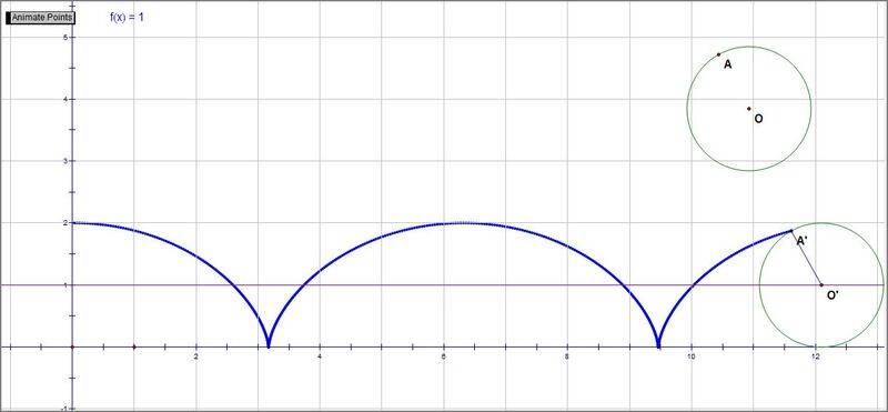

A car travels forward with constant velocity. It goes over a small stone, which gets stuck in the groove of a tire. The initial acceleration of the stone, as it leaves the surface of the road, is?
a = v^2/r
So I thought the stone would initially experience acceleration in the backward (leftward) direction then continually accelerate in the inward direction of the tire (i.e. upward then rightward then downward then leftward, etc.) as the tire moves forward. But the answer is immediately upward acceleration. Not sure why that is.
Thank you.
You are probably thinking of its motion relative to the car.
The part of the tire that is in contact with the road is traveling backwards relative to the car.
All other parts of the tire have a forward component to their motion.
For example, the top of the tire is moving twice as fast as the car.
Any point on the surface of the tire will follow a cyclonic path:
Good heavens no. This is cyclonic
Your figure shows a cycloid.
I actually typed in cycloid. But then the spell-checker suggested cyclonic. I didn't look closely and assumed it wanted an adjective instead of a noun - something like "cycloidic" - so I agreed to the change.
I will now change it back ... and add "cycloid" to my computer dictionary.
