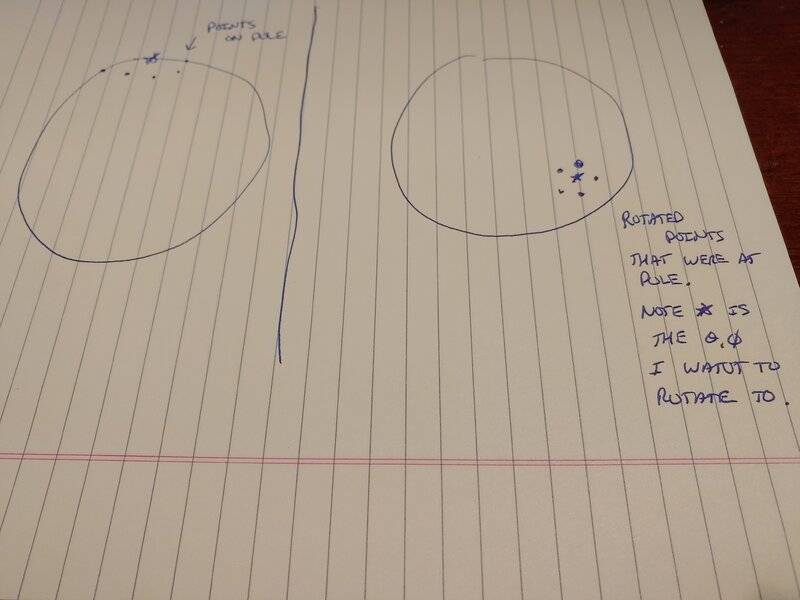

Dear Forum,
My goal is to rotate several points on a sphere by a theta and phi. For example, I have a sphere where the elevation is theta (90 to -90) and the azimuthal is phi (-180 to 180). I have the following points on the sphere:
theta = [45 45 45 45]
phi = [-180 90 90 180]
This generate several points to define a circle on the top of the circle. My goal is to rotate the four points by theta 115 (or theta = -25) and phi 160. With this the center of the circle will have the vector (theta=115,phi=160) and the four points will be around the center and new theta,phi locations.
I have been unsuccessful trying trying to do this with a rotation matrix. I appreciate any ideas to help me solve this problem.
OP, please also note that your first and last points are the same as well as your second and third. If you want four points around the pole, you should include phi=0 and phi =-90.
Dear All,
Here is what I have tried. I first make 5 points very close to the top of the pole if you will.
Code:
phi_vals = [-180:90:180]
theta_vals = 1.5*ones(5,1)*(180/pi)
My goal is to rotate these points so that they are projected toward a theta,phi. However, they will be around the center by a ~ 1 degree. I write a loop to generate a v with the different points.
Code:
for i=1:length(phi_vals)
s1 = cosd(phi_vals(i))*sind(theta_vals(i))
s2 = sind(phi_vals(i))*sind(theta_vals(i))
s3 = cosd(theta_vals(i))
rot_theta=116
rot_phi=160
t1 = cosd(rot_phi)*sind(rot_theta)
t2 = sind(rot_phi)*sind(rot_theta)
t3 = cosd(rot_theta)
v = [s1;s2;s3]
axis=[t1;t2;t3]
theta = acos(dot(v,axis));        % angle between vectors
axis = axis/(sqrt(dot(axis,axis)))
a=cos(theta/2)
val = -axis*sin(theta/2)
b=val(1)
c=val(2)
d=val(3)
aa=a*a;bb=b*b;cc=c*c;dd=d*d;
bc=b*c;ad=a*d;ac=a*c;ab=a*b;bd=b*d;cd=c*d;
%%%%  Euler–Rodrigues Rotation %%%%
er_array=[(aa + bb - cc - dd) (2*(bc + ad)) (2*(bd - ac));(2*(bc - ad)) (aa + cc - bb - dd) (2*(cd + ab));(2*(bd + ac)) (2*(cd - ab)) (aa + dd - bb - cc)]
rot_array = er_array*v
[az,el,r]=cart2sph(rot_array(1),rot_array(2),rot_array(3));
rec_phi(i) = az*(180/pi)
rec_theta(i) = 90-el*(180/pi)
My thinking is that I would have five points that very close to theta=116 and phi=160. However, the points are too far a way from 116,160 to make sense. Any idea what I am missing?
I am following this guide
https://en.wikipedia.org/wiki/Euler–Rodrigues_formula
Not entirely sure what you are doing here. This will give theta values of ca 85 - i.e., around the equator.
Edit: No wait, you are using inclination instead of the polar angle, yes that will be close to a pole.
Edit 2: No wait again, your formulas indicate that you are using it as the polar angle ...
James_1978 said:
rot_theta=116
rot_phi=160
v = [s1;s2;s3]
axis=[t1;t2;t3]
It is not clear to me what you are trying to do here. You are defining an axis and letting "theta" equal the angle between the defined point and that axis. There are many things awry here.
You don't need to do this based on your previous code. Your axis is already normalised by construction.
James_1978 said:
a=cos(theta/2)
b=val(1)
c=val(2)
d=val(3)
You seem to be using the axis containing the point you want to rotate to as the rotation axis and the angle between the point and the axis as the rotation angle. This will not work. If you want to rotate the point to theta = 116 and phi = 160, you cannot have that point as the rotation axis because it will make that point a fixed point of the rotation, which means no other point can map to it. You should also not be using different rotations for different points. You need to construct your rotation matrix based on what you want to do, which is to make a single rotation rotating the center of your points to the desired direction and seeing what the rotation does to your other points.
If you take a point on the sphere and want to rotate it to theta = 116 and phi = 160 by using the angle between the vectors as the rotation angle, then your rotation axis needs to be perpendicular to both the target point and the point of origin. You can obtain a perpendicular vector through the cross product.
Dear Orodruin,
Thank you for the response. I have attached a picture to better explain what I am trying to do. Please let me know if this helps.
