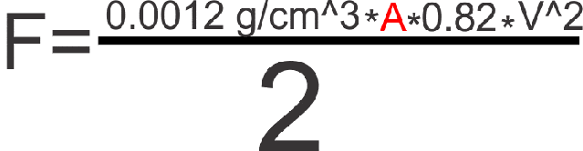

The drag force is F = ½ρACdv2
Use Cd = o.82 for drag force on long cylinder, and ρ = 0.0012 g/cm3 for air. See long cylinder and other shapes in

Ok, let’s go step-by-step :smile:
First of all: did I write this equation correctly?
Also: What is A in numerator?
Which units should we use? Grams or kilograms? In SI system kilograms and meters are used, so perhaps we should use only them :smile:
What about V? Apparently this is value of linear velocity at rod’s end? :shy:

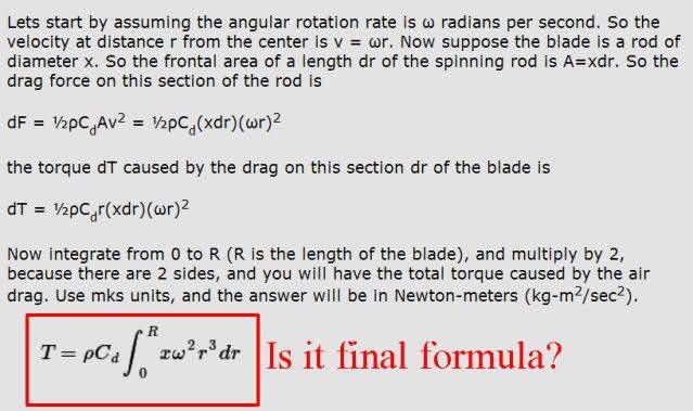

Lets start by assuming the angular rotation rate is ω radians per second. So the velocity at distance r from the center is v = ωr. Now suppose the blade is a rod of diameter x. So the frontal area of a length dr of the spinning rod is A=xdr. So the drag force on this section of the rod is
dF = ½ρCdAv2 = ½ρCd(xdr)(ωr)2
the torque dT caused by the drag on this section dr of the blade is
dT = ½ρCdr(xdr)(ωr)2
Now integrate from 0 to R (R is the length of the blade), and multiply by 2, because there are 2 sides, and you will have the total torque caused by the air drag. Use mks units, and the answer will be in Newton-meters (kg-m2/sec2).
[tex]T = \rho C_d\int_0^Rx \omega^2 r^3 dr[/tex]
Bob S
Bob S

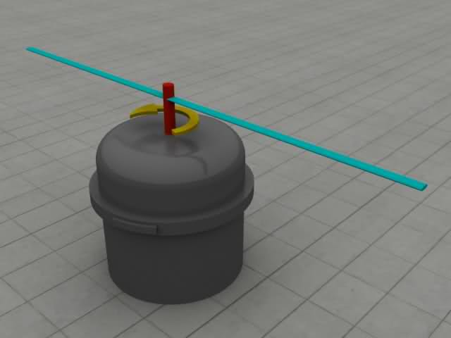

Also: when you mentioned the length of the rod you probably meant the whole length of it, at both sides, but what if we had the rod at one side only?
if you want to calculate the torque for half of the rod use the formula bob s gave you and take half of the length, which is your variable r if i understand correctly.
so [itex]\frac{r}{2}[/itex] and when you insert it into the formula it should be [itex](\frac{r}{2})^3 = \frac{r^3}{8}[/itex]
The equation for the torque T is for two blades, each of length R. If you have only one blade, divide by two.

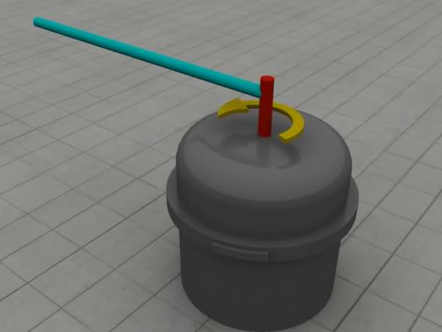

This confuses me a bit :smile: imagine that we have got such situation:
and the length of the blade is let’s say 1 000 meters, so what number should we write in that formulas? 1000 or 500? :rolleyes:
R in the equation for torque is the length of the blade, from the axis of rotation to the tip of the blade. Your illustration shows one blade of length R.
Bob S

Eagle9-
For each blade of length R, the torque T is
[tex]T =\frac{ \rho C_d}{2}\int_0^Rx \omega^2 r^3 dr=\frac{\rho C_dx \omega^2 R^4}{8} Newton-meters[/tex]
Bob S
