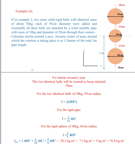

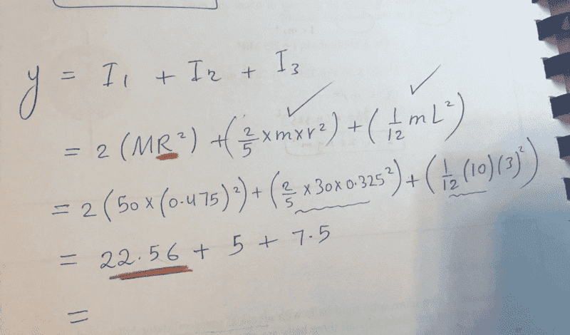

i just don't know from where to take the R which is colored with brown, in the 2(MR^2), what is the R here exactly, because i took the radius of the sphere , but i get different answer althought it's near.

Why is the moment of inertia of the rigid pipe about the y-axis ##(1/12)m L^2##? That's the moment of inertia about the x-axis passing through the mid point of the rod.

yeah the sysytem will be rotating around z ( perpendicular to the page) as we have (x,y) fixed point, so the system will be rotating in the plane of x and y but around z. so the axis of rotation z is perpendicular to the pipe and at the center of it, so that why i used 1/12.

The text says it is about the y axis. However, that wouid mean the information about the length of the rod and the spacing of the balls is irrelevant. I notice also the dashed horizontal line through the mass centre. All of this suggests the text is wrong and that the rotation is about the x axis.
I am dubious of their assumption that the two identical balls can be "treated as hoop material". I think that will introduce a significant error (I estimate a bit more 10 %).
I would think that it should be the distance of the centers of the large spheres from the axis of rotation.
so the radius of the big sphere + 2.5+ the radius of the center sphere?
That would be my view, yes.

yeah i understood that the text says , it will rotate in the plane of x-y. but to make sure, it will move like a pin wheel right? and what about the R so? which R should i take?

No, the text says it will rotate about the y axis, about the axis of the rod, so in the XZ plane. But that is at odds with several other clues, which indicate rotation in the YZ plane. Yes, like a pinwheel, but about the x axis, not the z axis. Anyway, as I posted, the answer is the same for X and Z.

Yes of course, I should have said "That's the moment of inertia about the x-axis passing through the mid point of a very thin rod. Thank you for the correction. The point remains that the moment of inertia used by OP is incorrect. I am also troubled by the assertion in the solution that the two outer spheres are treated as point masses with moment of inertia each ##Mr^2## instead of using the parallel axis theorem.

You need another formula. It looks like you are not expected to be able to derive these formulae for yourself, so I will show you.
Consider a disc slice of the rod, radius r, thickness dy, at distance y from the x axis. Its mass is mdy/Y, where Y is the length of the rod and m its mass.
By the parallel axis theorem, its MoI is (mdy/Y)[¼r2+y2].
Integrating, ¼r2m+(1/12)mY2.
Yes, that is clearly wrong.

The basic premise of the Parallel Axis Theorem is that if you know the MoI for some object of mass M about a given axis, then the MoI for that same object about another axis parallel to that first axis is given by:
##MoI_{new} = MoI + Md^2##
Where d is the distance between the new axis and the original axis.

It's not that complicated really, but it looks like you have been poorly taught.
You have three solid spheres, and for each you can use the standard (2/5)mr2 formula. The outer two are off-axis, so you need to use the parallel axis theorem. Effectively, this says that each of these spheres can be represented by a sphere of the same mass and radius located at the axis, plus a point mass of the same mass located at the actual centres of the spheres.
Similarly, it turns out that a solid cylinder (thick rod) rotating about an axis normal to its own can be treated as a thin disc of the same mass located at the axis (as a diameter of the disc) plus a thin rod of the same mass.
