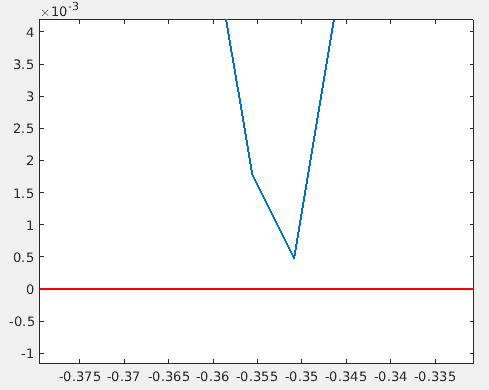

bremenfallturm said:
An insight into how the error is currently calculated:
1. I want the error to be small around x=a, in the first case a=0 and in later assignments I both need small errors around a1= (to check if the serve is approved) and around a2=1.2.
2. What I do is use Runge-Kutta 4 to solve for the x-values and find the n values close to a, currently I use n=3 since I interpolate with degree 2.
I don't follow. Does this explain how you calculate the error ?
When I compare ##y## after a step of size ##h## (your 5e-4) with ##y## after two steps ##h/2##, I get close to machine precision !

Kind of. :biggrin: I have tried to introduced Richardson's extrapolation and used the error ##|E_{rich}|=|\hat y - y|##, see above, but my truncation errors are nowhere near machine precision. That's probably because there is an error in the way that I calculate them.
BvU said:
When I compare y after a step of size h (your 5e-4) with y after two steps h/2, I get close to machine precision !
What ##y## do you compare to do that? And how do you find out where in the "solution" matrix the new ##y## is stored? Since I use a variable step size for when ##y\rightarrow 0## (using the secant method to find what ##h## to use each time), I do not get the matrix sizes to match up nicely between iterations.
Sorry if it's hard to follow along what I'm doing, especially when you don't have any code.

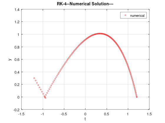

Coming back to
I've now changed it to 0.00005. ##\mathcal O## is 0.5⋅10−6, which is the highest error tolerated by the assignment.
and
"The answers should have at least 6-8 correct digits, somewhat depending on question" (yes, this is what the assignment says)
when you report
x-values for comparison for fun, here's what I get using the initial conditions given in the top post: (for the three bounces before x=1.2)
-3.53496e-01 4.3385e-01 9.1342e-01
Where I'm afraid I have to remark that this doesn't satisfy the 'at least 6-8 correct digits' :rolleyes: ...
(and the ##\mathcal O## is also on edge -- I personally would take 0.5E-7 or even 0.5E-8 ...
When I finally got something to work (see #18) the results allow guestimating the 'correct digits':
(step size, ##x_0## for bounce 1,2,3)
5.0e-5 ##\qquad## -0.353496957103320 ##\qquad## 0.433854331752568 ##\qquad## 0.913422978195822
5.0e-4 ##\qquad## -0.353496957103362 ##\qquad## 0.433854331752487 ##\qquad## 0.913422978195706
5.0e-3 ##\qquad## -0.353496957539166 ##\qquad## 0.433854330903075 ##\qquad## 0.913422976982109
2.5e-2 ##\qquad## -0.353497244187681 ##\qquad## 0.433853767233959 ##\qquad## 0.913422170776847
So a step size of 5e-3 looks like a safe choice with 8+ significant digits.
Step size 5e-4 gave me local truncation errors of machine precision (#32), so I tried again with step size 5e-3.
Forget about the bouncing, just integrate from 0 to t=0.3 in 60 steps.
What y do you compare to do that? And how do you find out where in the "solution" matrix the new y is stored?
Gives me 61 vectors ##(t_n,x_n,y_n,\dot x_n, \dot y_n)\quad ## n = 0 to 60
At each of these points ##n## I also do a two step RK4 with step size 2.5e-3.
That gives me a vector ##(t_{n+1},x^*,y^*,\dot x^*, \dot y^*)\quad ##
So I have (in MIT (7.17 notation) ##y(x+h)## and ##y(x+h/2+h/2)##.
And therefore an estimate of the local truncation error for both horizontal position: ##x_{n+1} - x^*## and vertical position: ##y_{n+1} - y^*##.
In pictures:
x(t) is almost a straight line and y(t) is almost a parabola :smile:.
The red lines show the local truncation error estimates (I dubbed them 'u-v' somehow) All negative.
Even a pessimistic global error estimate (just add absolute values) yields a maximum uncertainty in ##x## and ##y## after 54 steps of
about 2e-10. Consistent with the 9 significant digits above.
With the bouncing back in: two or three steps to find the exact moment are enough; the accumulated error for the first bounce will still be 2e-10 and the second and third a bit more. But no reason at all to halve step sizes.
I can't answer 'where in the "solution" matrix the new y is stored?'
In the fortran I added an array for the ##+h/2+h/2## results. In your matlab that would be a second solution matrix, I suppose.
I see pbuk added two posts. Will look at them later.

  • #40
Just showing off :oldshy: . Don't have MatLab, so downloaded Octave and fought my way in. Both horrible and fascinating at the same time (for a 1980's Fortran 77 'expert'). Results identical to what I already had in all digits -- including the error estimates and the bouncing points
( -0.35349695753917 ##\qquad## 0.43385433090308 ##\qquad## 0.91342297698211 )
Infinite hassle to wrap a program into a subroutine and other Octave/MatLab ideosyncracies now stop me from moving forward. Temporarily, I hope :rolleyes: .
Just so I understand parts 2 and 3: Isn't it enough for part 2 to insert a small step backwards when ##y## falls below 0.12 -- in the same way as is done when y falls below 0 to find the bouncing points ? And then when this ##x_{y=0.12}## is added to/subtracted from -1.2 2 is done?
And in 3 you want the second bounce at ##x=1.2##, right ? (haven't played that game for ages...:smile:)
