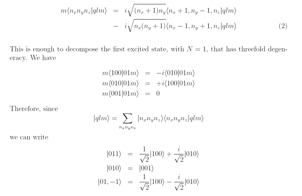

I struggle to understand the given argument for how to represent the three states in the cartesian eigenbasis. I tried writing it out but with no success. I would appreciate if someone could walk me through it step-by-step.
Given in picture.
step-by-step
All steps ? Do you understand the first step (from (2) to the 'we have' triplet) ?
What I'm confused about is how the representations were obtained from the closure relation. I understand everything before it. I don't see how to get rid of the inner products after making use of the closure relation.

For ##N = 1 = n_x + n_y + n_z## when you apply the completeness relation you get a sum states in coordinate basis for each ##n_i=1##, for a total of three states, each with an inner product between the coordinate and spherical bases (the bra-kets on the very right in the completeness equation). I don't see how those turn into coefficients of ##1/\sqrt{2}## as presented in the final results.

Now,how do you determine those coefficients? Simply take the dot product with basis vectors and use orthonormality of basis vectors(Also,Use the relation that was derived just after equation (2).

I am trying to carry out the same relations and I have noticed that the expression (2) is only compatible if the state is acted \begin{align*}a_x^{\dagger}a_y\ket{n_xn_yn_z}\end{align*} with the conjugate complex, that is, by making
\begin{align*} \bra{n_xn_yn_z}a_xa_y^{\dagger}&=\bigg(a_x^{\dagger}a_y\ket{n_xn_yn_z}\bigg)^{\dagger}=\bigg(\sqrt{(n_x+1)n_y}\ket{n_x+1,n_y-1,n_z}\bigg)^{\dagger}\\
=&\sqrt{(n_x+1)n_y}\bra{n_x+1,n_y-1,n_z}
\end{align*}
So
\begin{equation*}
\bra{n_xn_yn_z}a_x^{\dagger}a_y=\bigg(a_xa_y^{\dagger}\ket{n_xn_yn_z}\bigg)^{\dagger}=
\sqrt{n_x(n_y+1)}\bra{n_x-1,n_y+1,n_z}
\end{equation*}
This is the form to find the expression (2).
Later,
\begin{align*}m\braket{100|01m}=-i\braket{010|01m}\hspace{2cm}N=1, n_x=1,n_y=n_z=0\end{align*} and so with the others relations
Starting with the eigenstate $$q=0,l=1,m=1$$ , it holds that the sum of terms is
\begin{equation*}
\ket{011}=\braket{100|011}\ket{100} +\braket{010|011}\ket{010}+\braket{001|011}\ket{001}
\end{equation*}
when $$m=1$$, so the relations are
\begin{align*}
\alpha&=\braket{100|011}=-i\braket{010|011}\\
\beta&=\braket{010|011}=i\braket{100|011}\\
\gamma&=\braket{001|011}=0
\end{align*}
For ortonormality of states , $$\braket{011|011}=1$$, such that
\begin{equation*}
1=|\braket{100|011}|^2+|\braket{010|011}|^2=|\alpha|^2+|\beta|^2
\end{equation*}
Observing,
\begin{align*}
\alpha=-i\beta\\
\beta=i\alpha
\end{align*}
Therefore,
\begin{equation*}
1=|\alpha|^2+|i\alpha|^2=2|\alpha|^2\implies \alpha=\frac{1}{\sqrt{2}}
\end{equation*}
Reemplacing this value of α and β, it is concluded that the state $$\ket{q=0,l=1,m=1}$$ is
\begin{equation*}
\ket{011}=\frac{1}{\sqrt{2}}\ket{100}+\frac
{i}{\sqrt{2}}\ket{010}.
\end{equation*}
