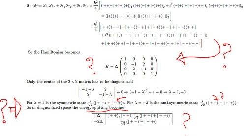

Actually, my question is I don't understand the portion indicated in the picture attached. Please see the picture. How they got 4x4 matrix from the previous line, and how they got symmetric and antisymmetric states for those eigenvalues, 1 and -3 respectively and also, how the got the total energy splitting. I am quite weak in these matter. It would be better for me, if you could explain these.

I know how to solve eigenvalues. My question is not that. I actually don't understand how they get the 4x4 matrix from the previous line of spin product expression? I mean, they directly wrote the Hamiltonian as 4x4 matrix from the previous line. I don't know how they did that from that spin product?
There is a basis for the space of two particle states which is \{ |++\rangle, |+-\rangle,|-+\rangle,|--\rangle \}. We can choose an index i and label these states as | i \rangle for i = 1,2,3,4. Then the Hamiltonian can be written
\hat{H} = \sum_{ij} H_{ij} | i \rangle \langle j |.
The coefficients H_{ij} are the elements of the matrix corresponding to \hat{H}.
