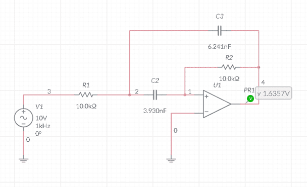

I worked out the Bandwidth at: 1500Hz so therefore Fh should be 4050Hz and Fl should be 2550Hz
Could someone give me any tips as to how correct my key is? with respect to the Bode plot on the sinusoidal output of my design the peak voltage is 2.2331 so the dB output of 20log(vo/vin) gives me 6.9782 which seems a little low.
Any help is much appreciated

Op amp inputs have been accidently swapped in your schematic, too.
Actually, what he has drawn is a multiple feedback filter with the opamp inputs swapped. In a sallen key filter, the input is on the positive input and there is positive feedback with the negative input taken from a voltage divider on the output.
More than that - the shown circuit is not a lowpass but a BANDPASS filter in MFB topology.

Berkeman, this was the one I thought was the most appropriate as it is very briefly shown in my notes as a bandpss filter with no other explanations.
I got the bandwidth of 1.5kHz by dividing the fo/Q. this gives the upper and lower corner frequencies
I used the value of R1 as 3.3Kohm which using the equation R2=R1(2Q) squared = 62.888k ohm
Using the equation 1 / (2x pi x f x R) I got C1 as 6.241nF and C2 as 3.930nF so this is where th above design has come from.
But you're right the inputs of the op amp are the wrong way around
I'm just looking for a bit of help as to whether I'm heading in the right direction?
Thanks for the replies
Here are the design equations for your circuit:
Mid frequency: wo=(1/R1C2)*SQRT[R1C2/R2C3] ,
Midband Gain: Ao=R2/[R1*(1+C3/C2)]
Q-factor: Q=SQRT[Ao/(1+C2/C3)]=SQRT[R2C3/R1C2*(1+C3/C2)²]
I forgot to mention that a simple design allows two equal capacitors (C2=C3).
In this case, we have R2/R1=4Q².
